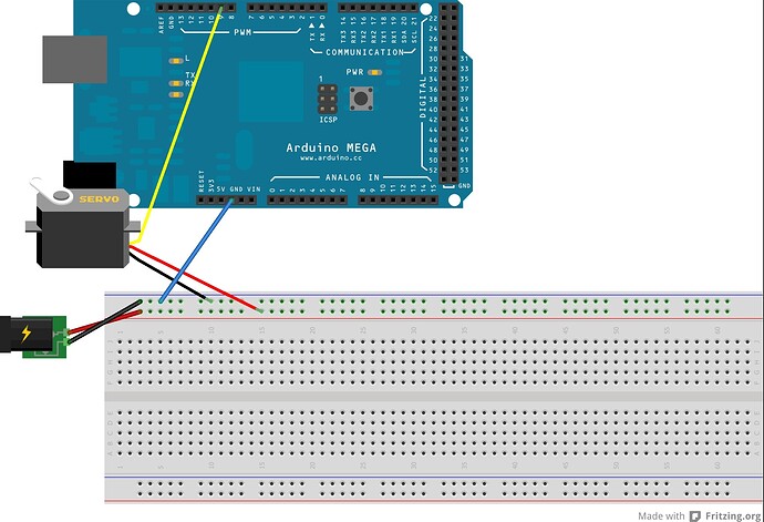

I have 6 servo's I am using for a project.
I need to connect a 6 volt external battery pack to power the servo's.
I have set it up but cannot get the servo to move at all. If I test one servo powered through the arduino 5v then it moves no problem. but I cannot do this for 6 servo's. (A also made sure gnd was connected to battery gnd and arduino gnd)
I have attached the schematic for my setup below of just one with an external power supply which doesn't work :frowning:

Is that exactly how you have it?- if you use those power rails on breadboard, there's often a break in the middle so if you have connections towards both ends, there might be no path across the middle. edit- see attached pic
Have you checked with a meter that you have voltage at the right place and that there is continuity of all connections?

Have you measured the battery pack voltage with a meter? Also a servo can draw up to 1A so you need to make sure your pack can provide that.
If you power the Arduino through Vin, it should be over 7V.
You could also try without the breadboard in case there are one or more faulty sockets- it's not many connections, you could just hold them together with your fingers. Or tape them.
Check the supply voltage is getting to the servo and that its ground is definitely in
common with Arduino ground.

I will check that voltage is getting through to the servo's, I don't see what would be stopping it though if voltage wasn't getting to it. Any ideas?
Loose wires, flat battery, faulty sockets in the breadboard...

I checked connections with a multimeter
Thankyou everyone for your help and advice, the problem has been solved, it was in fact dodgy clips.
