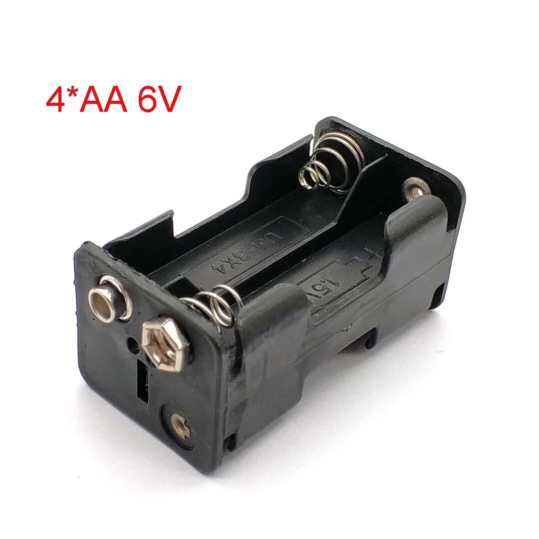

Do you have a recommendation of an alternative power supply I can use?

Only if you know the stall current of the servo.
