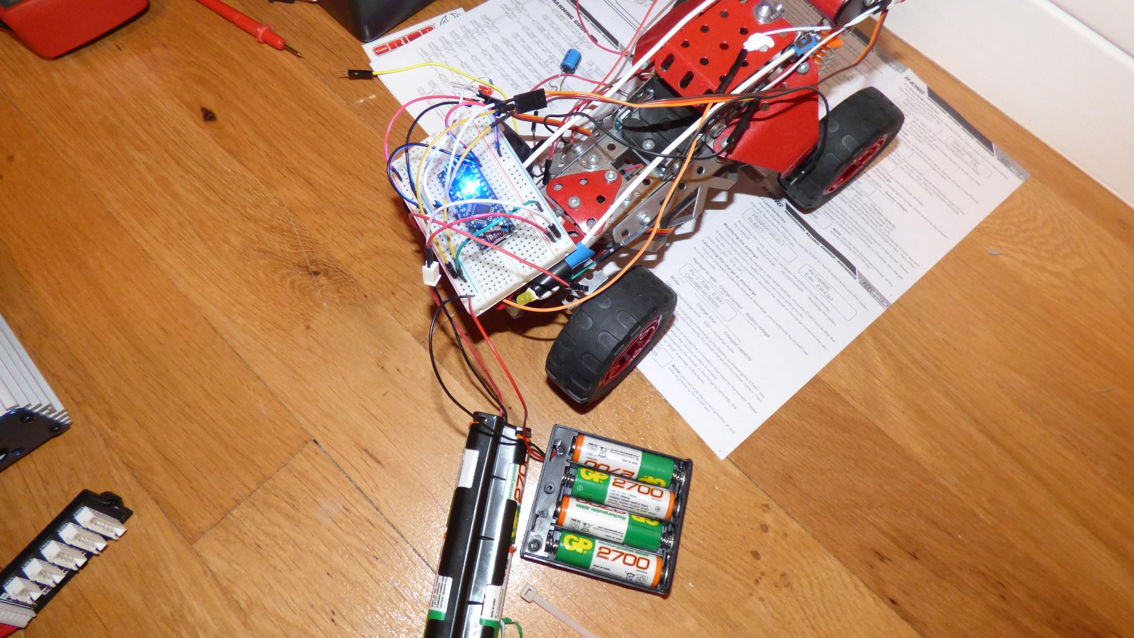

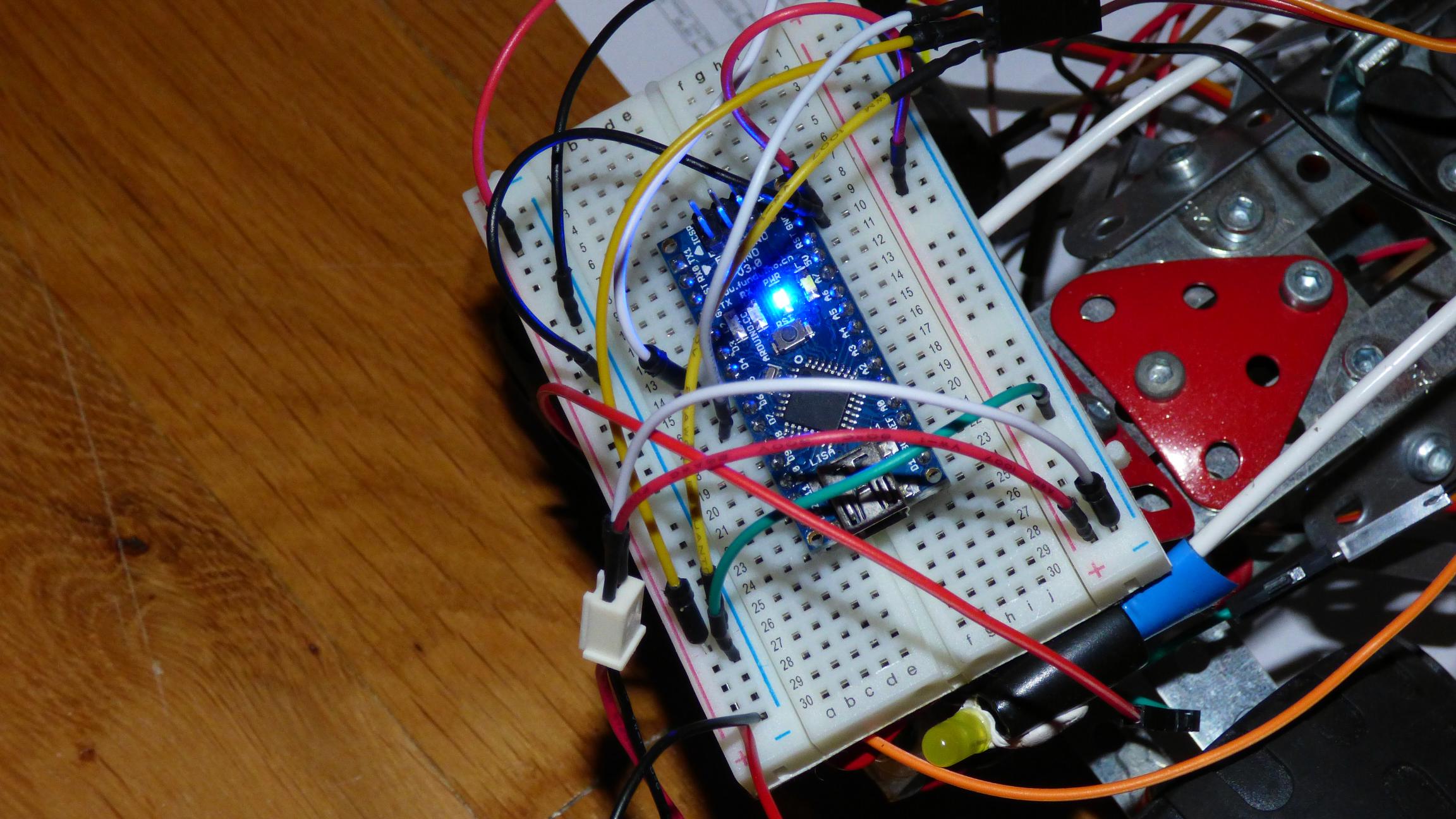

just two pictures to show the wiring that actually works but requires two separate power supply.
I will try to see where the resistance is actually located.
OK, after a bit a seraching I think I found the problem : for some reasons, one type of the rechargeable batteries I am using has a voltage getting down to 0.5 V when delivering current.
I think this explains the multiple switch off /switch on. I will buy new ones and see if it fixes the problem.
Thanks for the advices
SOLVED !
I bought better 1.5 V rechargeable batteries and their voltage does not get down when the thing is operating : everything works all right !
Thanks ! you put me in the right searching direction !
