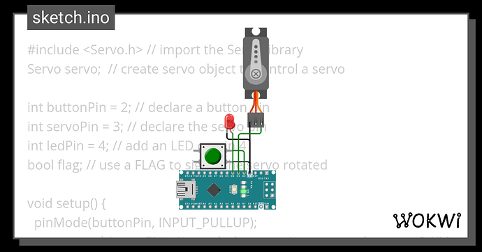

What position will the servo start at? When you push the button, how far will the servo move? how long will the servo remain at that position before returning? How often will that sequence occur?
Code dump time already? "We" hadn't even introduced the button, yet. Sorry, @adidab14 I wasn't posting fast enough. Nobody likes a thorough explanation.
Click here for sketch.ino for WOKWI.COM
#include <Servo.h> // import the Servo library
Servo servo;  // create servo object to control a servo
int buttonPin = 2; // declare a button pin
int servoPin = 3; // declare the servo pin
int ledPin = 4; // add an LED on pin 4
bool flag; // use a FLAG to signal the servo rotated
  pinMode(buttonPin, INPUT_PULLUP);
  servo.attach(servoPin); // attach the servo instance to the servo PWM pin
  servo.write(90); // rotate the servo to 90 degrees.
  if (!digitalRead(buttonPin)) { // is the button pressed?
    delay(100); // this is a quck, ugly way to debounce the button ringing noise
    if (flag) { // indicates if the servo rotated
      flag = !flag; // change the flag to the opposite state for the next servo movement
      servo.write(0); // rotate the servo to 0 degrees
      digitalWrite(ledPin, HIGH); // turn LED ON
      delay(15); // this lets the servo catch up after the command
      flag = !flag;
      servo.write(180); // rotate to opposite direction
      digitalWrite(ledPin, LOW); // turn LED OFF
      delay(15);
Click here for diagram.json for WOKWI.COM
  "version": 1,
  "author": "Anonymous maker",
  "editor": "wokwi",
  "parts": [
    { "type": "wokwi-arduino-nano", "id": "nano", "top": -4.8, "left": -0.5, "attrs": {} },
    { "type": "wokwi-led", "id": "led1", "top": -109.2, "left": 71, "attrs": { "color": "red" } },
      "type": "wokwi-servo",
      "id": "servo1",
      "top": -221.8,
      "left": 49.8,
      "rotate": 270,
      "attrs": {}
      "type": "wokwi-pushbutton",
      "id": "btn1",
      "top": -51.4,
      "left": 28.8,
      "attrs": { "color": "green" }
  "connections": [
    [ "nano:GND.2", "servo1:GND", "black", [ "v-86.4", "h-19.2" ] ],
    [ "nano:GND.2", "btn1:2.r", "black", [ "v0" ] ],
    [ "nano:GND.2", "led1:C", "black", [ "v-57.6", "h-38.8" ] ],
    [ "nano:2", "btn1:1.r", "green", [ "v0" ] ],
    [ "led1:A", "nano:4", "green", [ "v9.6", "h-67.2" ] ],
    [ "nano:3", "servo1:PWM", "green", [ "v-67.2", "h38.2" ] ]
  "dependencies": {}

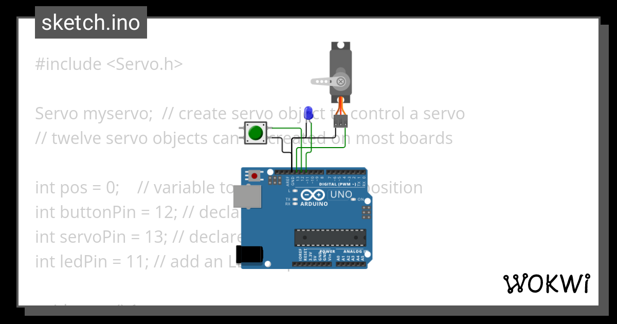

i've been tinkering with this for a bit and i keep getting some sort of wonky infinite loop once i press the button. it's like parsing the code or something with the button and i don't know why. I have a feeling i'm screwing up the for loop inside the if statement for the button or something. At least the button does... something. so i'll take that as a minor win :slight_smile:
Here's the code i mutilated:
#include <Servo.h>
Servo myservo;  // create servo object to control a servo
int pos = 0;    // variable to store the servo position
int buttonPin = 12; // declare a button pin
int servoPin = 13; // declare the servo pin
int ledPin = 11; // add an LED on pin 11
  myservo.attach(13);  // attaches the servo on pin 13 to the servo object
  pinMode(buttonPin, INPUT_PULLUP); // configure pin with pullup resistor.
  // Pressed = LOW, normal = HIGH
   if (digitalRead(buttonPin) == 0) { // read the button pin to see if it is LOW
   delay(150); // debounce
      for (pos = 0; pos <= 180; pos += 1) { // goes from 0 degrees to 180 degrees
      // in steps of 1 degree
      myservo.write(pos);              // tell servo to go to position in variable 'pos'
      delay(15);                       // waits 15ms for the servo to reach the position
      delay(5000); // servo wait for a moment at 180 degrees
      for (pos = 180; pos >= 0; pos -= 1) { // returns from 180 degrees to 0 degrees
And the Wokwi
https://wokwi.com/projects/390202682510372865
Compared to the one i posted earlier you can see that the it's all sorts of messed up from what i want :smiley:
Please, do not use slang and think you are describing technical observations, especially when you use words incorrectly.
Please, describe what you see, what part of that you want to keep, what part you want to discard, what part you want to change and in what way, and what you would like to improve upon, and in what way.

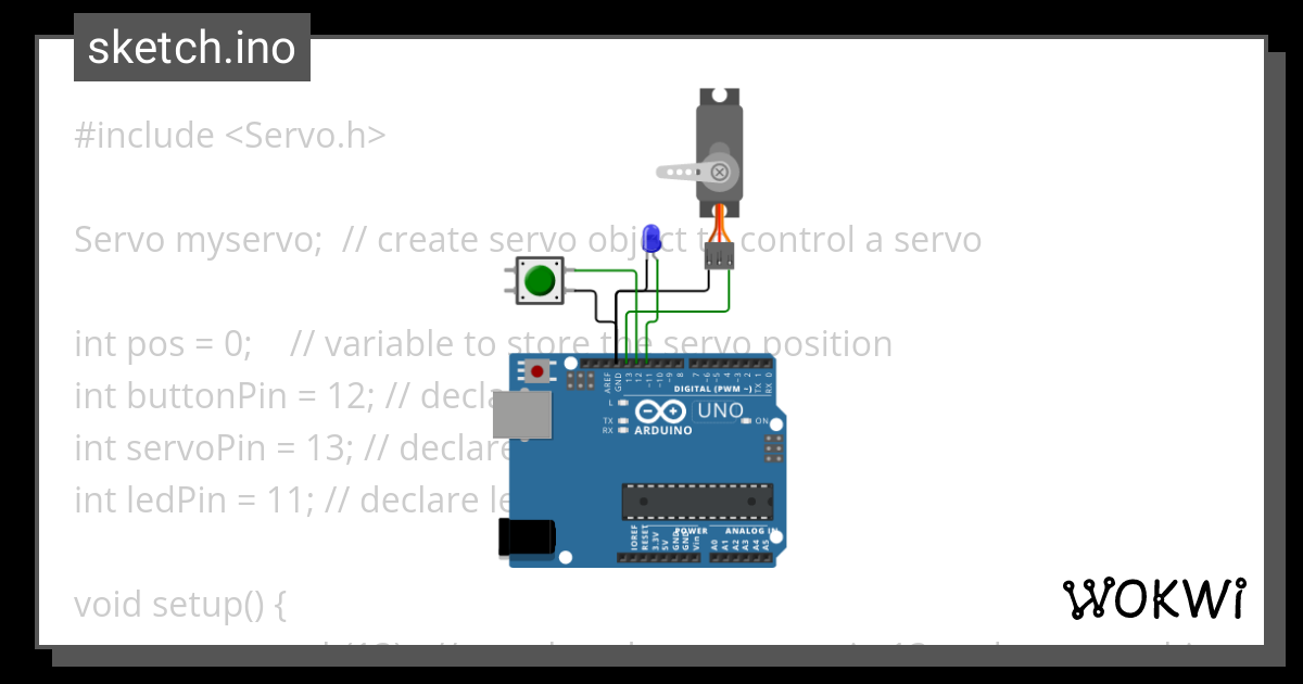

Sorry sorry! Basically, i want this:
But not to loop forever. Ideally, i want to hit the button, servo goes from 0 to 180, sits at 180 for a little, and then returns to 0 and stays there until i hit the button again. If i could get a light to work it would light up from 0-180 and then shut off when the servo returns from 180 to 0. That first Wokwi does exactly that (but goes forever instead of just one loop), but when i try to incorporate the button, it doesn't quite do what i want. Everything is out of order for some reason as shown below:
And here's the code
1st wokwi code:
#include <Servo.h>
int buttonPin = 12; // declare button pin
int ledPin = 11; // declare led pin
    for (pos = 0; pos <= 180; pos += 1) { // servo from 0 degrees to 180 degrees in steps of 1 degree
delay(5000); // pause for some time at 180 degrees
2nd wokwi code:
#include <Servo.h>
I posted a working model of the method you describe in Post #5.
Is there a way to combine the two operations on the button presses? Ideally, i'd like the servo to start at 0, go to 180 on button press (LED turns on), it pauses there for a little, and then returns to 0 (LED turns off), and then stays there until the button is pressed again. Just like this but not a never ending loop:
In the code in Post #5, the servo starts at 90, on button press it goes to 180 and stays there (LED is off). Then on another button press it goes to 0 (LED turns on) and stays there. Then it returns (LED turns off) on another button press. So it would work but would just need a button pressed for each step and someone to monitor the time required to pause which isn't a total deal breaker but would make what i'm trying to do a bit more difficult. Buuuuut every time i try to get the operation to run all in one press, i break something and it doesn't work :frowning:
At what moment does the LED turn on? At button press? At 180?
At what moment does the LED turn off? After pause? At 0?
No. The servo starts at 0. Yes... i see. It does not start at 0.
Here is the update...
  • start at 0,
  • wait for button press,
  • rotate to 180,
  • LED on,
  • pause 5 seconds,
  • rotate to 0 degrees,
  • LED off.
  servo.write(0); // rotate the servo to 90 degrees.
    servo.write(180); // rotate the servo to 180 degrees
    delay(PAUSE); // pausing at 180 degrees
    servo.write(0); // rotate servo to 0 degrees
That's the ticket!! It seems so simple but for the life of me i could not figure that out. Thank you so much. The only thing i can see needing now is possibly a way to slow the servo down if it moves too fast but i found a library that looks like it can do exactly that should i need it.
Now all that's left is to figure out how the heck to power this thing.
Thanks again!!
