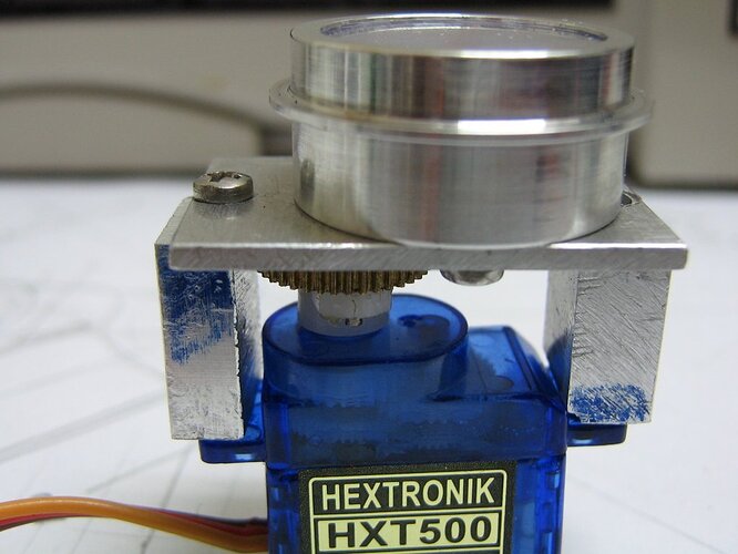

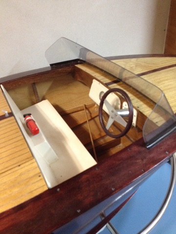

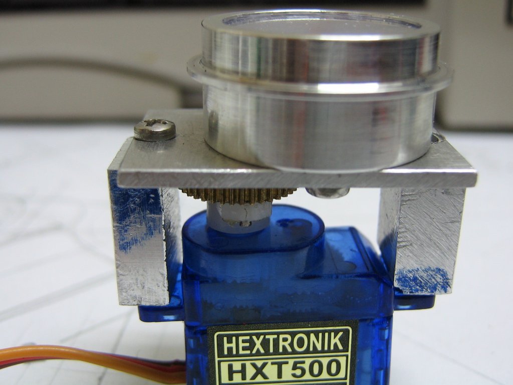

It was my choice on a model boat for the tacho.
At the time a simple code (only a few lines actually) was sketched up for a picaxe 8m micro and used a 5gm servo with gears on the output to turn the normal rotation into 270 degree movement on the needle.
Works great.
Meter itself is 20mm diameter.
The meter was designed and drawn up using Jim Tonnes meter software (basic version) At US$55 for the full version it is a bit out of reach for hobby use but the basic version is fine.

Similar to what's used in actual auto clusters with real needles.
