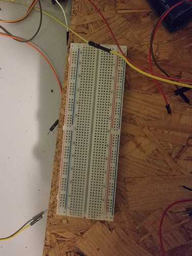

Hello everyone, I have a problem with servo motors. I'm building a robotic arm with 6 servo motors, specifically 3 MG90S and 3 MG996R servos. After connecting everything as shown in the diagram, the servo motors seem to be confused and lack the power to move.

which diagram?
how are they powered?
sorry didn upload photo
The devices You mention are named servo, not "servo motors". It's a great difference.
To what pin are those 4 x 1.5 volt connected? For Vin it is too little and for 5 volt it is too much.
Using a breadboard to distribute 6x servo current is not good. Use protoboard and soldering.
can you post the real picture of your setup?
also
the MG90S typical current draw (during movement) is between 120 and 250mA and can go up to 700mA (all current)
the MG996R typical current draw (during movement) is between 500 and 900mA and can go up to 2.5A (all current)
that's a lot for your 4 AA batteries (and as @Railroader says, for going through the breadboard)
also the Arduino has a separate battery pack, you need to share the GND of that pack with the GND of the servo's battery pack
So I am using this protoboard and those battaries. What I need to change for my servomotors start moving like they shoud?

Your breadboard is split in two at the middle so carefully if you use the power rails, you need a jumper in the middle for continuity
The small DuPont wires you show in the pictures are a bit small for very demanding servos.

Only for the high power ones use wires with a larger section than the cheap far east made DuPont cables that have only a handful of strands. Electric cable will do - I suppose you don’t have long sections anyway

I was try to connect servos with phone chargers 5V 2A and Arduino had other external power but the are still glitching. Maybe new batteries and eletric cable will help?
I believe that phone chargers will only deliver the 2 amps after negotiating a power setting with the attached device. Someone correct me if I am wrong please.
4 or 5 Ni-mh cells or two LiFePO4 cells are used for hobby servos in models. Some can handle the LiPo 2 cell voltage. 4 good AA alkaline cell will work too. But for long term use with the number of servos you are using you should get a 10 amp power supply. And use a different method to power them instead of the breadboard you are using.
