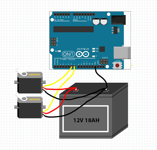

The wiring diagram is below.
Any advice would be great, thanks.

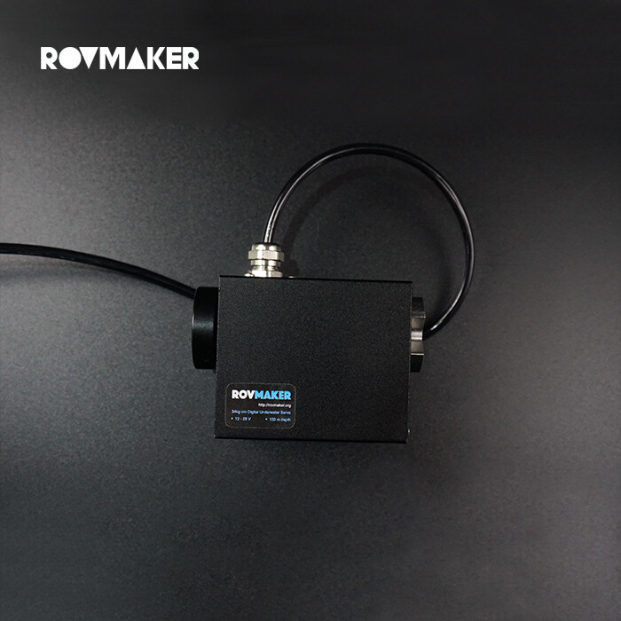

I've tried multiple quality batteries and the problem repeats so have ruled the battery out. Maybe the wiring is too thin. The 70cm length wiring comes with the servo as it's an underwater servo.
Link to the servos here: High Torque 40 KG Motor Micro Servo – ROVMAKER

Can you please post a circuit diagram and some images of your project?
So we can see your layout.

The application is basically a 2 axis gimbal that will be run off a 12v battery. The only image available atm is the circuit diagram at the top. Would a 'servo shield' be worth a try to fix the servo twitching?Thanks
What length of power carrying wire between the batteries and the servos?
Have you got the gnds connected exactly as in the picture in post #1?
That is star configuration to the battery negative post?
The power carrying wire is 70cm long on each servo and the wires that came with the servos are a little thin.
Yes, the grounds are connected just as in the diagram.

From your servo link: image
Servo library defaults for servo.attach(pin, min, max) is servo.attach(pin, 544, 2400)

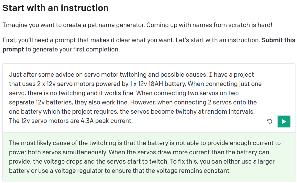

I entered the text from post#1 into Open AI ...
Rubbish.
Op says battery is 18Ah...how big do you think it needs to be..??
Maybe the battery is bad, maybe they say one thing and are doing another.
