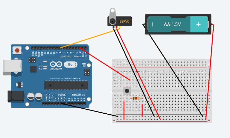

No. At least I dont think so. I'm not using the 5v pin on the board. I have 4 AA batteries that I have wired to power the servo. Here is a picture of my wiring. Hopefully I didn't mess something up here or else I'm going to feel dumb.
Sorry, impossible to make much sense of the photo. A hand drawn wiring diagram would be much better.
Do you have a common ground for the servo power and the Arduino? It is required.
Imgur
Here is a diagram of my wiring. The only difference is I have 4 AA batteries instead of the one shown on the diagram
That looks OK to me. Are the batteries fresh?
They should be. After doing some research it seems that the servos need a few Amps to work properly. Do 4 AA batteries supply enough Amps to run up to 6 servos? Could that be the problem?
So now there are six servos you are trying to power from four AA batteries? Yes, that could be a problem. :roll_eyes:
Get one servo working first.
AA batteries will power two servos at most, and only if those two are not straining at the same time.
Well I want to eventually power 6 servos for the project. What kind of power system do I need to eventually power 6 servos together? Any suggestions on what I should get?
Budget one ampere per straining servo, so for six straining servos you need a power supply capable of 5-6 V at 6 amperes.
