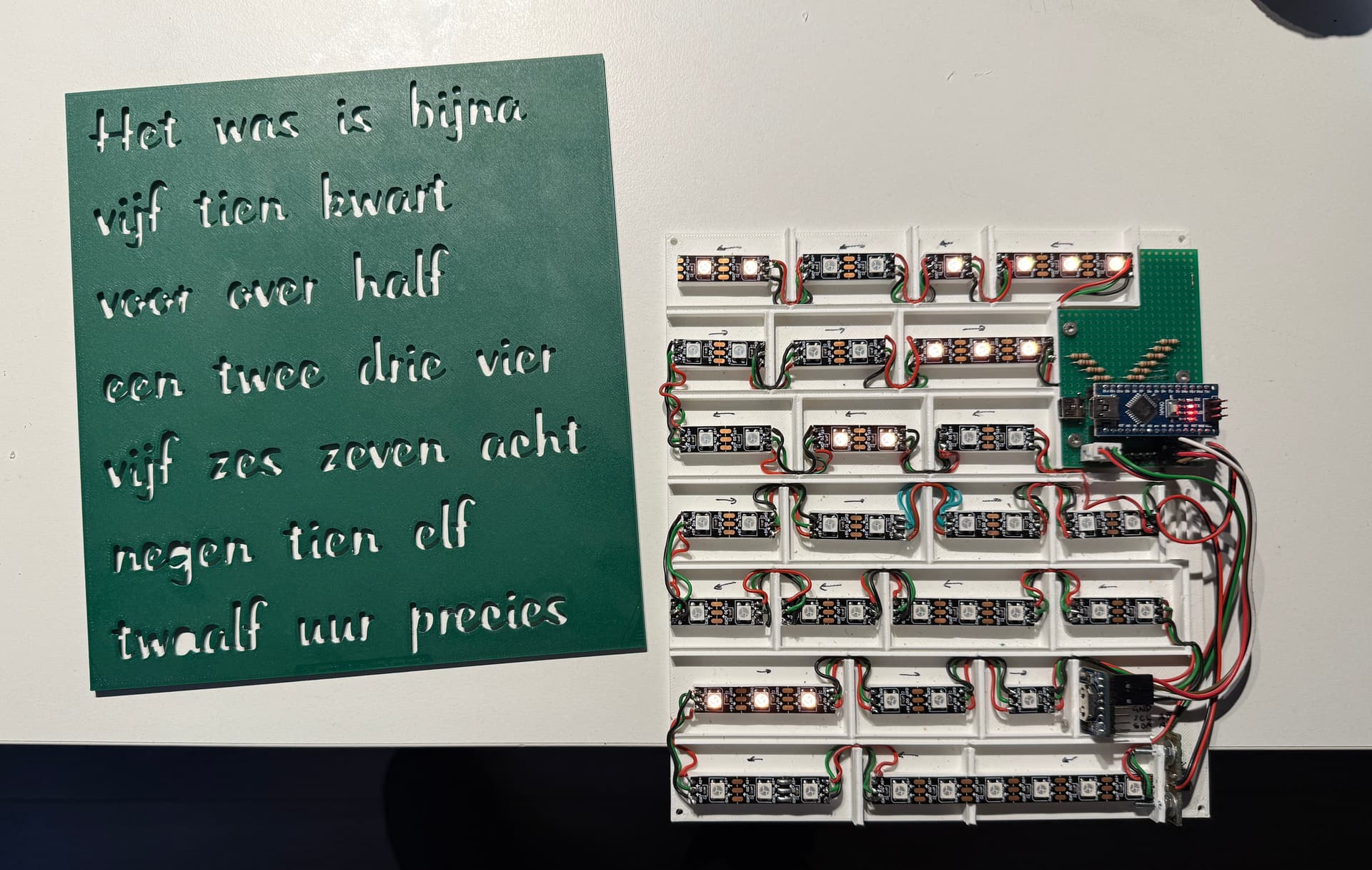

This is the clock I made. 20 by 22 cm.
Leo, you're right. I live in The Netherlands. So the Tekstklok will light up the words that describe the time. This picture is taken at 21:13h. "It is almost a quarter past nine".
I will definitely keep all your remarks and recommendations in mind when I'll build one big enough to hang on the wall. If my wife permits :wink:
To make it cordless, my biggest challenge will be how to power it without having to charge it every one or two days.
Nice project.
Mains power would be needed for a LED project like that.
