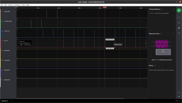

This works when I implement it on one node, but say suppose there are more then one node in the network for time synchronization. To solve and verify this, I produce a pulse every 5 seconds to see if the tick synchronization and verify time sync implementation. I fire an impulse at specific point in time using modulo(%) function, to get the right instant of time to start firing the impulse.
But the implementation is not accurate and reliable. I get variable latencies between tick, from 10ms to 22ms. Which is very high for tick synchronization. Please refer to my below code.

Lets say there are 2 LoRa ESP32 nodes. They both get time from Gateway to synchronize. After adding the offset in both the nodes, I want to produce impulse from the ESP32 nodes. Such that the impulse (or tick), from both the nodes are synchronized. Meaning the on both the ESP32 nodes, the time when a Digital Pin goes high/down is same. This is one of the application i am trying to develop.
But the problem there will be at what time they should start impulse, so that it they are synchronized. Because it will be good if the synchronization remains independent of the power-on of ESP32 (which is starting point for the micros(), to start counting.)
To solve this lets assume a standard wall clock, where we want to give an output impulse, on 5th min, 10th min, 15 min, 20min........ We can see they are all exactly divisible by 5 (== pulseInterval, in the code). So after adding the offset, the code will check when the the value of time, which leaves 0 remainder or a value close to it. This make the impulses to synchronize at the same time between two ESP32 nodes. (I am hoping to get accuracy below 100 micro seconds) :slight_smile: :sweat_smile:
Maybe the graphical representation, in the current implementation will help to be more clear.
The latencies changes when compared between separate nodes synchronized with the Gateway time. But perhaps this reference could help you to understand more better, for what I am trying to implementLongShoT: long-range synchronization of time
