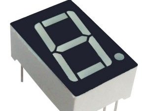

Hello, I'm just learning.
I have a little project, and having trouble
This is what I need to do
  • Display: Counts down from 15 to 0 on two 7-segment displays
  • LED-1: On by default, turns off when Button 1 is pressed
  • LED-2: Blinks during countdown, stays on after reaching 0
  • Button 1: Starts countdown
  • Button 2: Resets everything
  • No multiplexing: Each segment wired directly
I'm working with 2 seven segment displays common anode.
2 leds
These will be eventually replaced by relays to power a big display because of power requirements.
I cheated and used ChatGPT to work up a sketch.
The sketch works but displays the numbers like a predator gauntlet.
I cannot decipher in the code how the 7 segment displays are being illuminated.
Any help would be appreciated.
May have to hire someone for this.
code below
Thanks for looking

To which pins on the 7 segment displays have you wired the above Arduino pins ?
If you have not already checked the data sheet of the seven segment display for the correct mapping, then post a link to it here.
When the program starts, all the segments will be lit when the pins are set to OUTPUT in setup().
EDIT
This table is also odd (a) from the sorting order and (b) the difference between a '0' and an '8' should be only in one bit so this should also be reviewed to see if is simply the comments which are incorrect.

The segments of the displays are typically called as follows:
    -A-
  F|   |B
    -G-
  E|   |C
    -D-
Create a byte array where bit 0 corresponds to the lit segments, for example:
const byte digits[10] = {
  //ABCDEFG.
   B00000011,  // 0
   B10011111,  // 1
   ...etc...2 3 4 5 6...
Then it's a matter of connecting the segments to specific output pins of the Arduino, and writing the bit value associated with the desired digit (array index) to these pins.
The reason for the 'predator gauntlet' is basically the wrong array created by ChatGPT.
Once you understand the principle, the byte table and how to connect the pins are up to you.

I think the first comment below is correct. But the comments on the other lines are nonsense. Where did those comments come from?
// Segment mapping for numbers 0-9 on common anode 7-segment display
  B11000000, // 0
  B11111001, // 5
  B10100100, // 2
  B10110000, // 8
  B10011001, // 4
  B10010010, // 1
  B10000010, // 6
  B11111000, // 7
  B10000000, // 3
  B10010000  // 9
If I correct them:
  B11000000, // 0
  B11111001, // 1
  B10100100, // 2
  B10110000, // 3
  B10011001, // 4
  B10010010, // 5
  B10000010, // 6
  B11111000, // 7
  B10000000, // 8
  B10010000  // 9
Now, there is only one bit difference between '0' and '8', as expected. The count of zero bits for each digit seems to correspond to the number of lit segments, so I think this code is ok.
You have to wire the segments to the correct pins in order to get normal, non-predator numbers.
Take this example:
B10011001, // 4
Where the bits are zero, we want the corresponding segments to light to make the symbol "4" appear, like the upper-case letters here:
.aaa.
F...B
F...B
F...B
.GGG.
e...C
e...C
e...C
.ddd.
This tells us that the segment patterns should be understood as follows:
//gfedcba
B10011001, // 4
The zero bits would light segments b, c, f, g
The pins for the ones digit are as follows:
const int segPinsOnes[7] = {9, 10, 11, 12, 13, A0, A1}; // Ones display
So I think pin 9 should be connected to segment a, pin 10 to segment b and so on until pin A1 connected to segment g.
Is this how you have them connected?
If not, you can either re-wire them to match, or you can change the sequence of pins in the segPinsOnes array to match your wiring.
