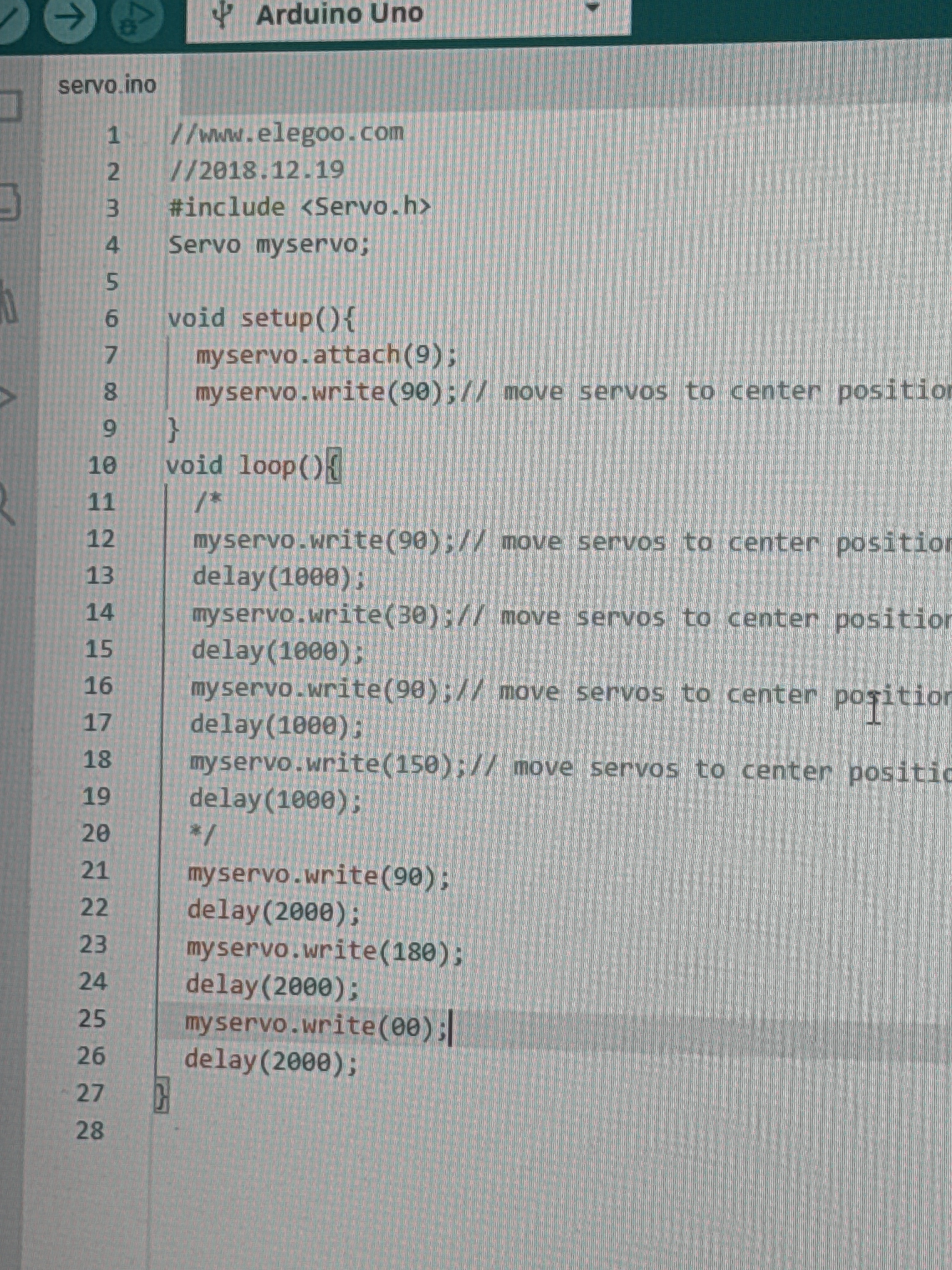

Trying to do a mini project with just my uno and a microservo SG90. Only problem is the servo isn’t moving. I can hear something going on towards the bottom of the servo, but it doesn’t move. This sound is like an electrical hum. Any solutions or do I need to buy a new one?

Please post the sketch that your are using, using code tags when you do. How is the servo powered and does it have any load on it ?
The servo is just hooked straight up to my Arduino, to the 5V pin. I’m working off of the basic Servo sketch (to test it before I begin the project)
That is not a sensible way to power a servo dues to the current requirements of a servo but should be OK for short term testing
Exactly which sketch are you using and which pin is being used for the servo data ?

This is the sketch I’m using (came with the arduino kit), and it’s attached to pin #9
Did you miss the request to use code tags when posting the sketch ? You will, of course, read the advice from the following link to which you were directed when you joined the forum

But the code shouldn’t be the issue, it’s a hardware problem. This is Arduino’s code.

The code did not originate from Arduino. See the first comment in it. It is probably not the problem but it does worry me that the comments don't match the code. That is never an indication of good code

It does sound like you have a bad servo
That is very likely to damage the Arduino. Power the servo separately (4xAA battery pack works), and don't forget to connect the grounds.

The servos are cheap. Buy a new one. If the first one turns out to be OK after all then you have a spare
If you are feeling adventurous then take the one you have apart and look for problems, they are simple enough
