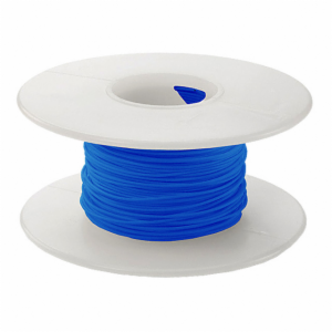

I use wire warp wire or magnet wire to make interconnections.
Wire Wrap Wire 30AWG
38AWG Roadrunner/Vero wire
Vero Wire
