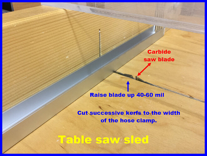

  2. Using a table saw sled, nibble out a slot wide enough for the hose clamp.

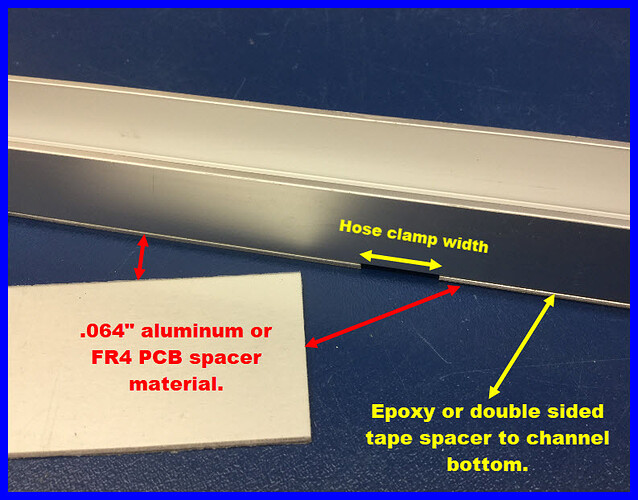

  3. Use two spacers under the channel.
Hose clamp thickness is typically .025”.
