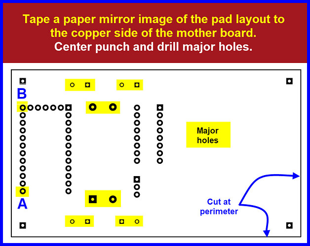

  1. Make a paper copy of the 1:1 mirrored image of our ‘PCB pad layout’.

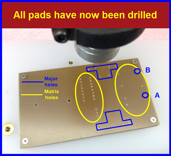

  2. Tape the layout to the copper side of our ‘mother board’. Note: components that do not have their pins matching a hole location on our ‘matrix drilling board’ need to have those holes drilled free hand. These holes will be referred to as ‘major holes’.
  3. On the paper image, center punch these ‘major holes’; discard the paper image.
  4. Drill the ‘major holes’.
  5. Align the ‘matrix drilling board’ to holes ‘A’ and ‘B’ as seen below.
  6. Tape the ‘matrix drilling board’ to the ‘mother board’.

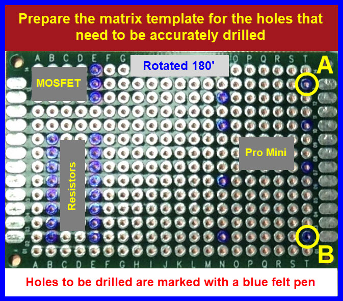

  7. Use a blue felt pen to mark all pads that need matrix drilling.
    Note: the drilling template allows for accurate drilling of matrix holes.

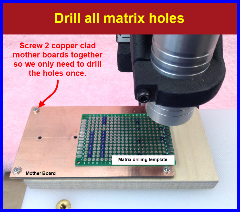

  8. Drill all the blue matrix holes.
  9. Use an engraving bit to chamfer all BUT the GND holes.

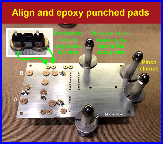

  13. Punch multiple pads from the .03” SS PCB material. (Alternatively, use a shear to cut square pads from the same material .)
  14. Align and epoxy these pads over the drilled holes, avoid getting glue inside the drilled holes.
    You can use header pins to align the pads to the holes in the mother board. Remove these pins before the epoxy sets.
  15. Align with header pins and epoxy the SMD daughter cards onto the top surface of the mother board; remove the alignment pins before the epoxy dries.
