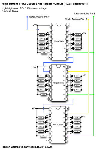

and this is how i connect the TPIC6C595:

You need a bypass capacitor for each chip. 0.1uF ceramic.
Start with something simple, less fancy.
See the bit where it says +5 in your diagram, then connect it to +12 instead.

In which case we need to see how you are connecting the TPIC6C59N to your Arduino. Code means nothing without knowing what it is driving.
Also just stick to one shift register first.

It is the latch pin, and transfers the internal state of the shift register to the outputs. It should be connect to all shift registers.

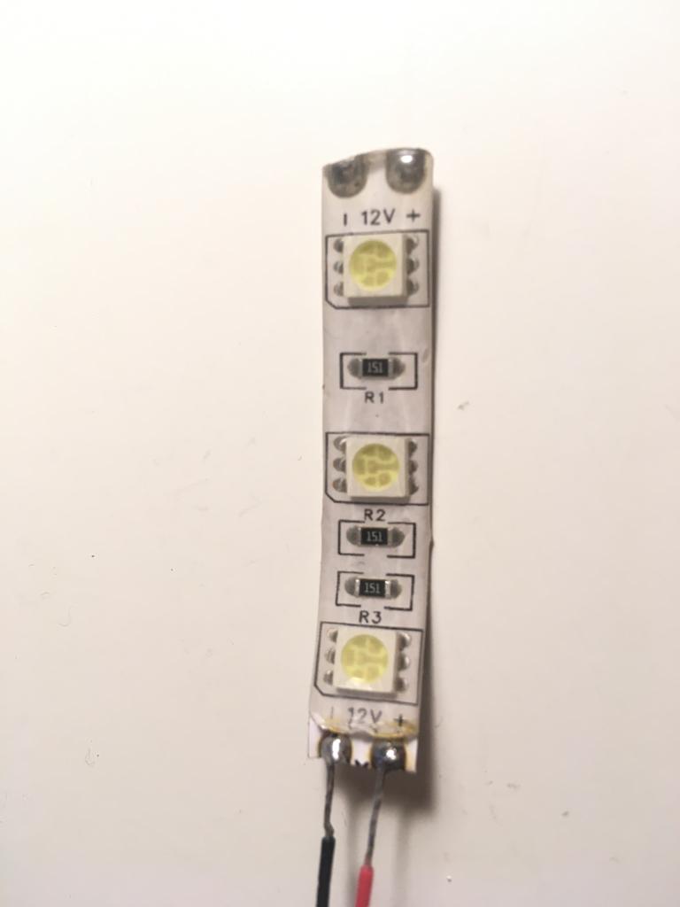

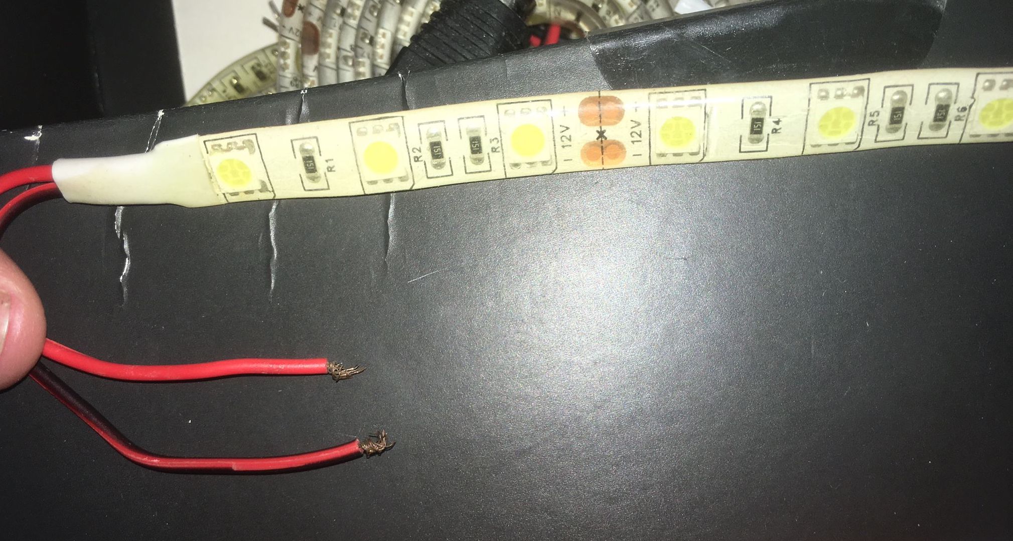

sorry i dont have the specs because these were my brothers from an old project of his but i believe they are just simple 12v led strips
You are very very wrong. These are not independent LEDs and they can't be driven with a TPIC6C59N at all.
They are in fact WS2812b LEDs fitted in groups of 3 in seriese which is where the 12V spec comes from.

Each output pin of the chip can drive a strip of at least 3 LEDs using a 12V supply. Maybe an output pin can drive a strip of 9 LEDs, but it depends on the strip, and it is difficult to know from the photos.

Yes you can't drive this strip with a shift register of any description. You need to use a library to generate the sequence of pulses required to drive the LEDs. Popular is the Fast LED library and Adafruit's Neopixel Library.
You are best using longer strips and arranging them in a zigzag pattern to form your matrix, although the aspect ratio of the matrix will be three to one. Is that acceptable? If not get a normal 5V strip of Neopixels from any supplier. The high the density, that is the pixels per inch, the more square will be your matrix pixels.
Search for the many examples of LED strip to matrix tutorials.

There should be a 3rd wire for the data if they were addressable LEDs. Where did that go?
