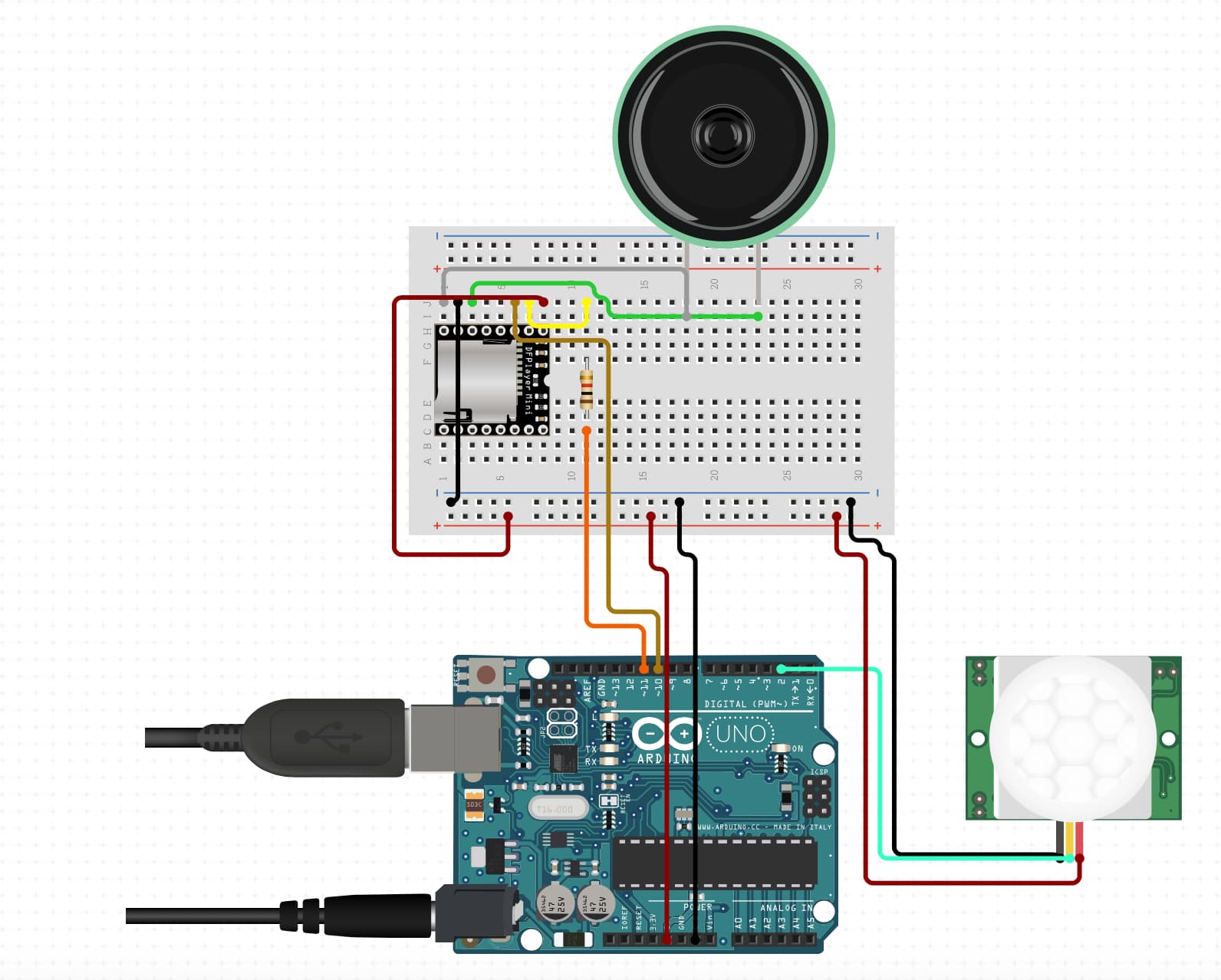

My connection between components looks like this:
So the HC-SR505 PIR-sensor has a plus & GND connection (on the sensor PCB the markings for are visible: left = GND, middle = signal, right is Plus).
The sensor's Signal leg is connected to pin 12 of the Arduino UNO R3 (so not pin 2 like in the image above).
Then the Arduino code looks like this:

Please let me know what you suggest to change.

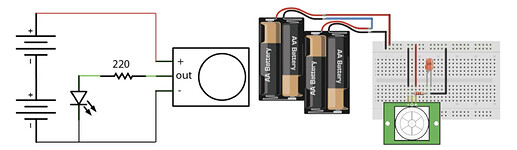

Test 1

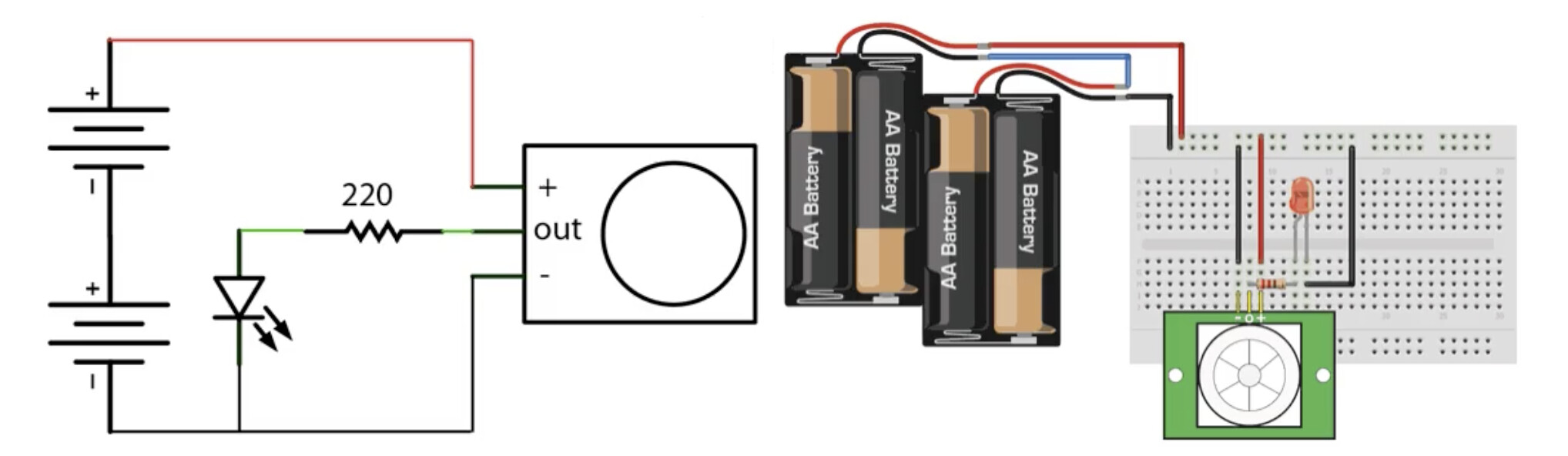

I followed your suggestion to first test the sensor. Since I have two of the HC-SR505 PIR sensors, I tested them both. Using this connection setup:
Results 1 (with both):
  • The LED turns ON when I turn on power, and then it turns OFF after 6-7 seconds.
  • Movement in front of the HC-SR505 PIR does not make the LED go ON. I tried different distances, no response.
  • I noticed when I physically tap/touch the dome on the PIR, the LED goes on.

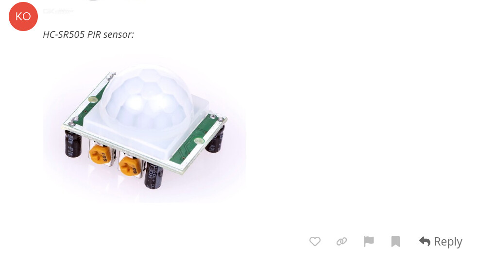

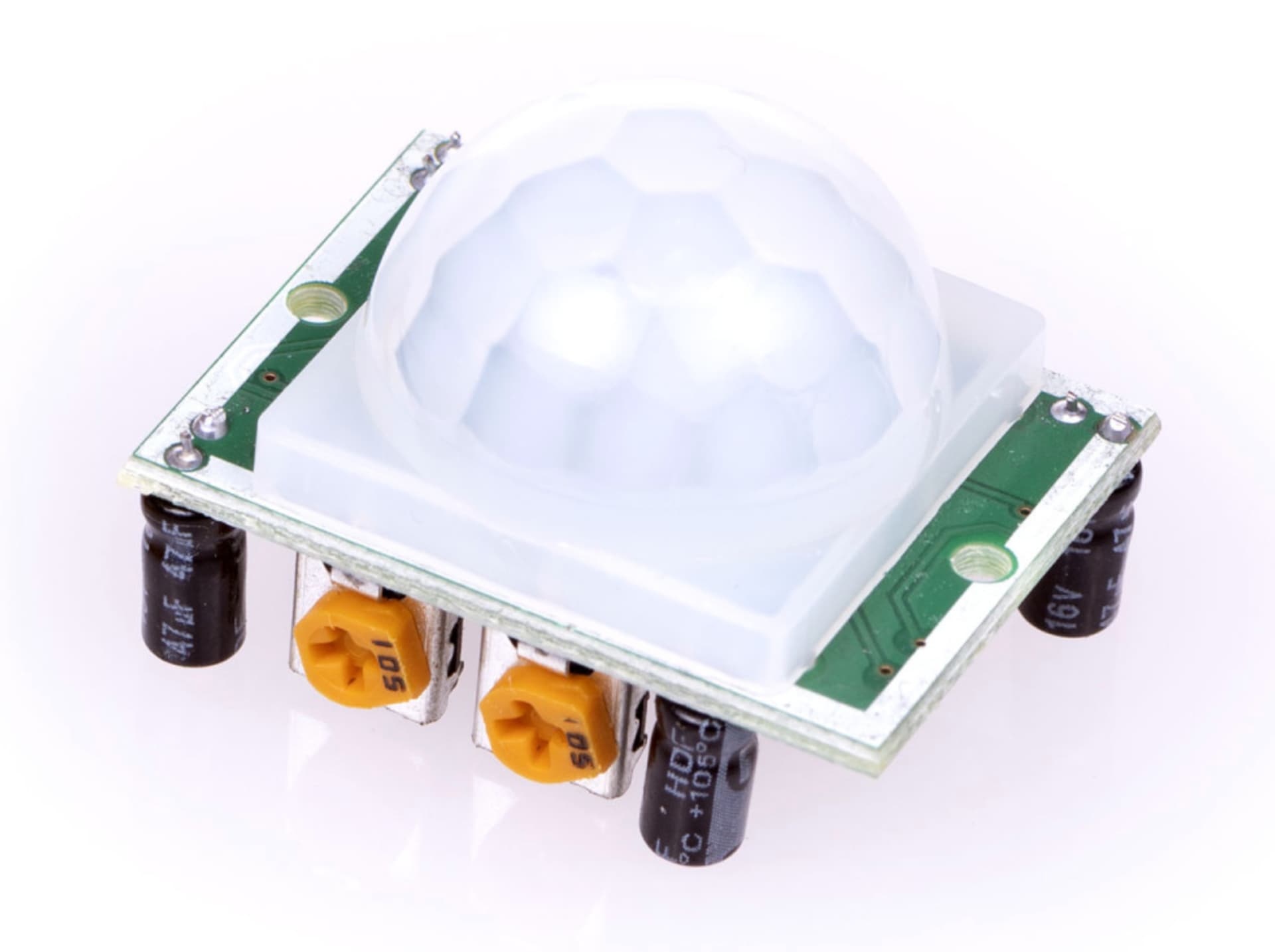

HC-SR505 PIR sensor:

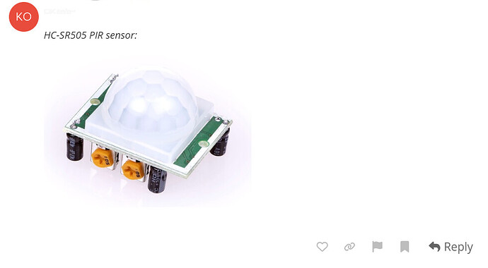

I recommended to do adjustments with jumper and delay time.
Can easily be, that you have set the sensor to not trigger for five minutes after the first power on...
Thnx again @kmin
Concerning your recommendation; The HC-SR505 does not have jumpers, and as far as I know the delay time cannot be set. Therefore I haven't been able to set the sensor for any other setting than its normal operation.

For possible bad contacts on the HC-SR505, I checked the contacts and PCB with a magnifying glass. Couldn't directly see bad contacts, though it didn't have quality soldering on the contacts. So I resoldered the contacts of the 3 pins and of the leads coming from the sensor itself to the board. And I did that with both sensors.
Re-test
Then I retested with both HC-SR505 PIR sensors. To be clear, everything is now directly connected with Arduino UNO R3 and DFPlayer (so no breadboard).
The first sensor was completely dead; no response to nothing. Not to movement and not to physically tapping the dome of the sensor.
With the 2nd HC-SR505 I have success. This one does respond to movement!
Conclusion
So I guess I was lucky that I have been able to save one of the 2 HC-SR505 sensors. Thanks for suggesting to check the contacts!
