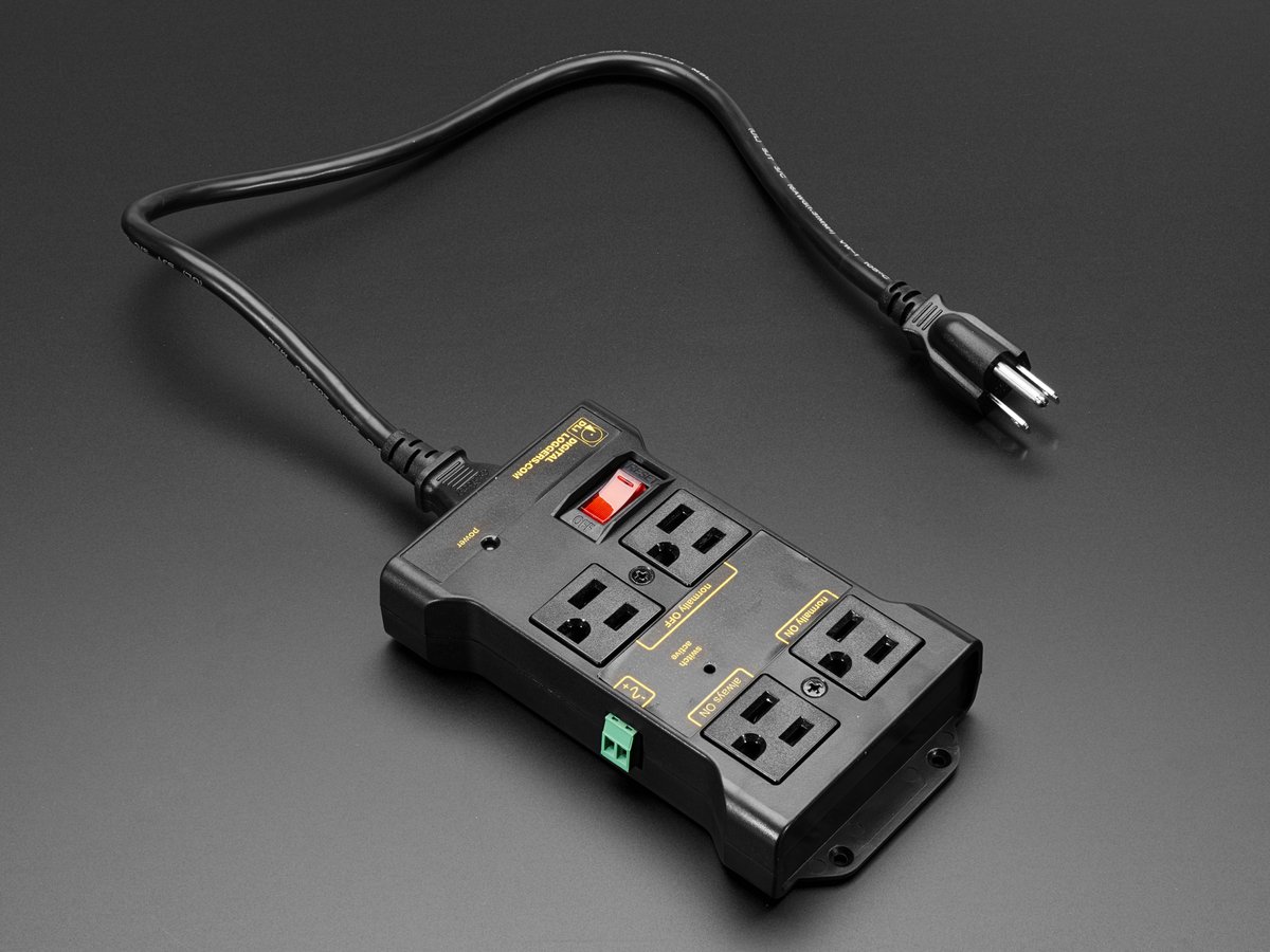

lbrooks9214:
-A 5v wire will be connected from the arduino (I think) to the relay
-The 120v wire stemming from the drill press will have the AC Plug cut off, and the severed end will be connected to the relay
-Another 120v will be plugged into the wall and the other end is connected to the relay.
(Essentially the relay will be in between the two 120v wires to power the machine tool, and the 5v from the arduino will be what turns the relay on and off, therefore it being powered controls whether or not the 120v will get power between the outlet and drill press)
I would be very very very inclined to get one of of these or similar.
edit: After checking the ratings, of course.

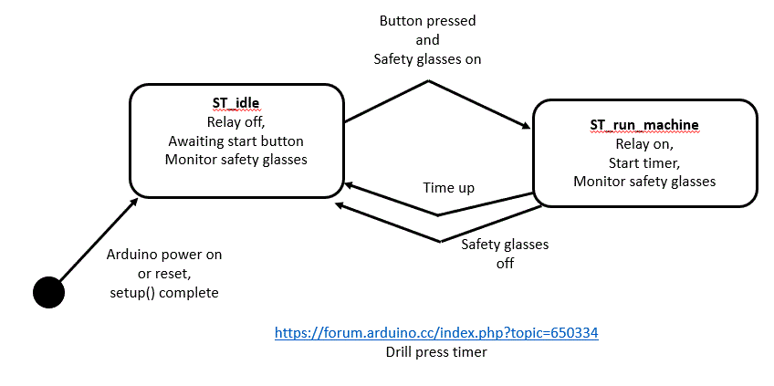

Here's my pseudo code and state diagram:
  • Check the safety glasses each time though loop(), set a flag safetyGlassesOn
  • Start in state st_idle. Relay off.. If runButton is pressed, and safetyGlassesOn is true, capture millis(), and go to state....
  • ... st_running. Turn relay on. Monitor safetyGlassesOn: if it ever goes false, change state back to st_idle which will turn relay off. Monitor increasing millis() vs captured start time: when it's expired, go back to st_idle.

OP I just wrote a sketch for the pseudo-code and state diagram from #13. Won't post it unless you want to see it. I just used a switch as a proxy for the safety test, reading it in a function, so easy to replace with "real" code for the "real" sensor.
