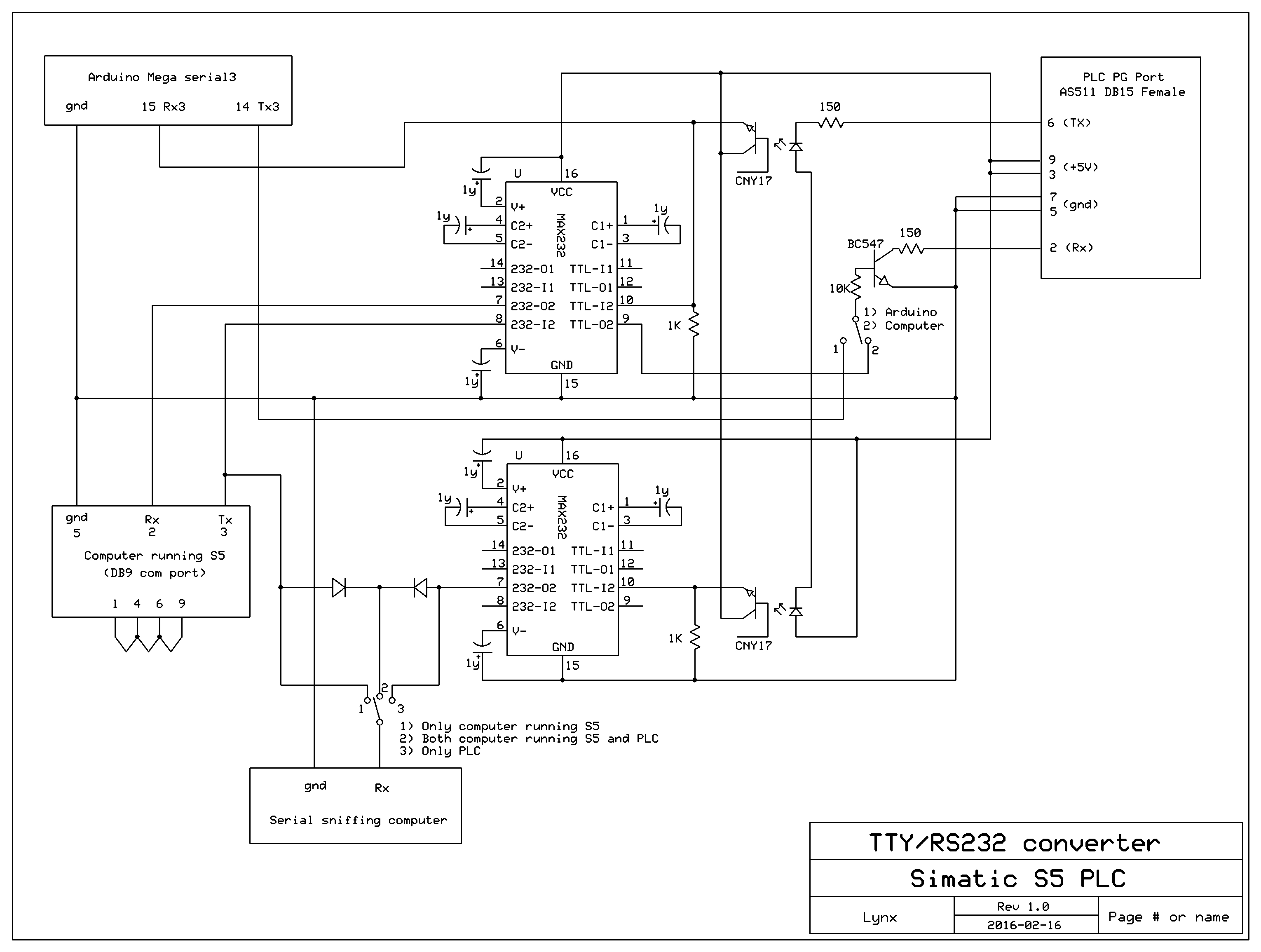

Here's a useful thing for Siemens Simatic S5 PLC's, it's an, however simple, Arduino/Adafruit LCD display- based operator panel designed to change the value of a dataword in a datablock in the PLC, will come in handy where there's a need for frequent changes of such a value.
It's based on using the navigation keys (Adafruit 2x16 LCD display with integrated buttons) for changing the value itself and then pressing the Select button in order to send the new value to the PLC.
I used such an Adafruit display including buttons which was originally designed for a Raspberry Pi, but I adapted it to a Arduino Mega instead, which wasn't too hard given that there's only 4 wires in all (+5V, GND, SDA and SCL) and those pins are already available on the Mega as is.
Hopefully I've explained the whole shebang in the sketch, shouldn't be all that hard for whoever to adapt the code to suit your own needs.

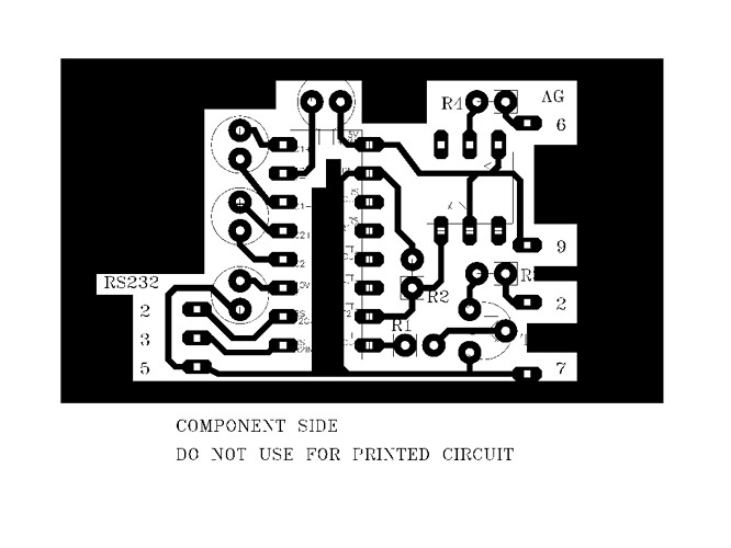

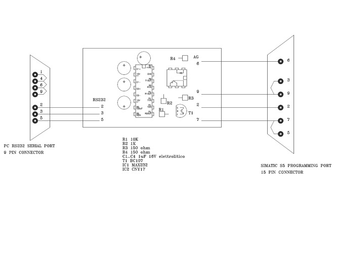

Converter TTY/RS232 : http://www.plcman.co.uk/232_20ma.zip (the "original" converter, the first one I replicated in order to be able to connect to a S5 PLC, works just fine!)
Schematics (of the above) TTY/RS232 converter : http://siodemka.p.lodz.pl/~kazz/rs2tty_838.gif

Note: Keep TTL (which includes both the Arduino serial ports and the AS511 PLC TTY interface) comletely separated from RS232 voltage levels at all times.
Mixing the two (TTL and RS232 voltages) can/will lead to destroying the Arduino's and/or the PLC's serial interfaces.
Use the schematics provided, which is based on the TTY/RS232 converter, as it works just fine both as an interface between the Arduino and the PLC and also as an interface to the serial sniffing computer running Realterm.

Hello, thank you for the informations posted here. I was looking a while to find how to address an S5 with arduino. I have still 2 questions : 1. how can I connect the mega directly to the PLC without sniffer or pc? (I use a 232 to TTY converter to program the PLC, but don't need it to be connected all the time, a connected HMI can show me the result in DB48); 2. What will be the command if I want to overwrite an other DW in the DB48 (DW18 for example)? Many thanks for any reply
