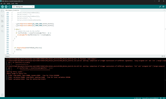

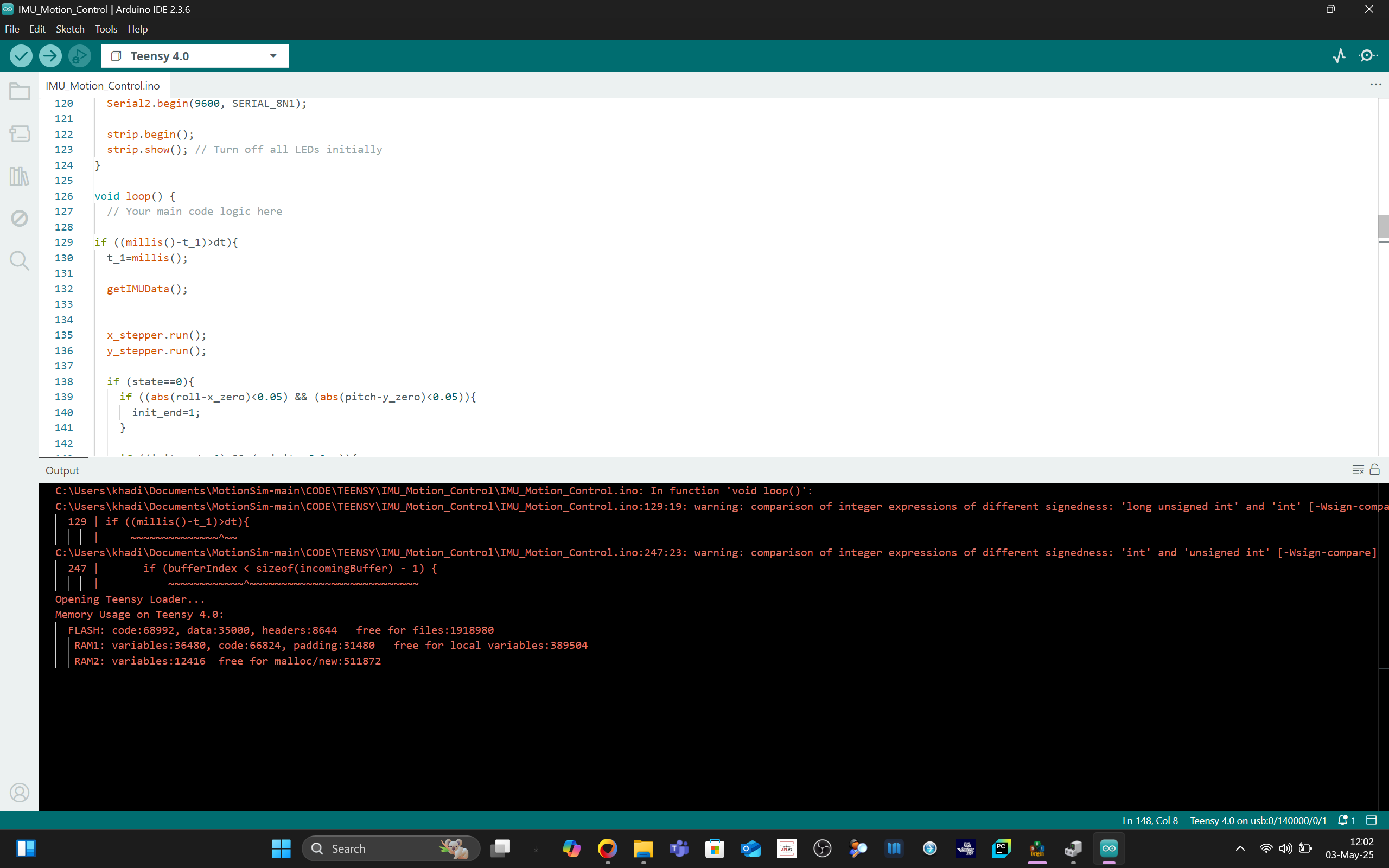

"sign-compare" warning when compiling a sketch
hey guys i have tried compiling this code but am having these two warnings comparison of integer expressions of different signedness and not sure how to resolved this any help correcting this code would be appreciated

Anyway, I would take a look in the type of the variables t_1, dt, bufferIndex and incomingBuffer.
millis(), for example, returns an unsigned long. What types does t_1 and dt have?
