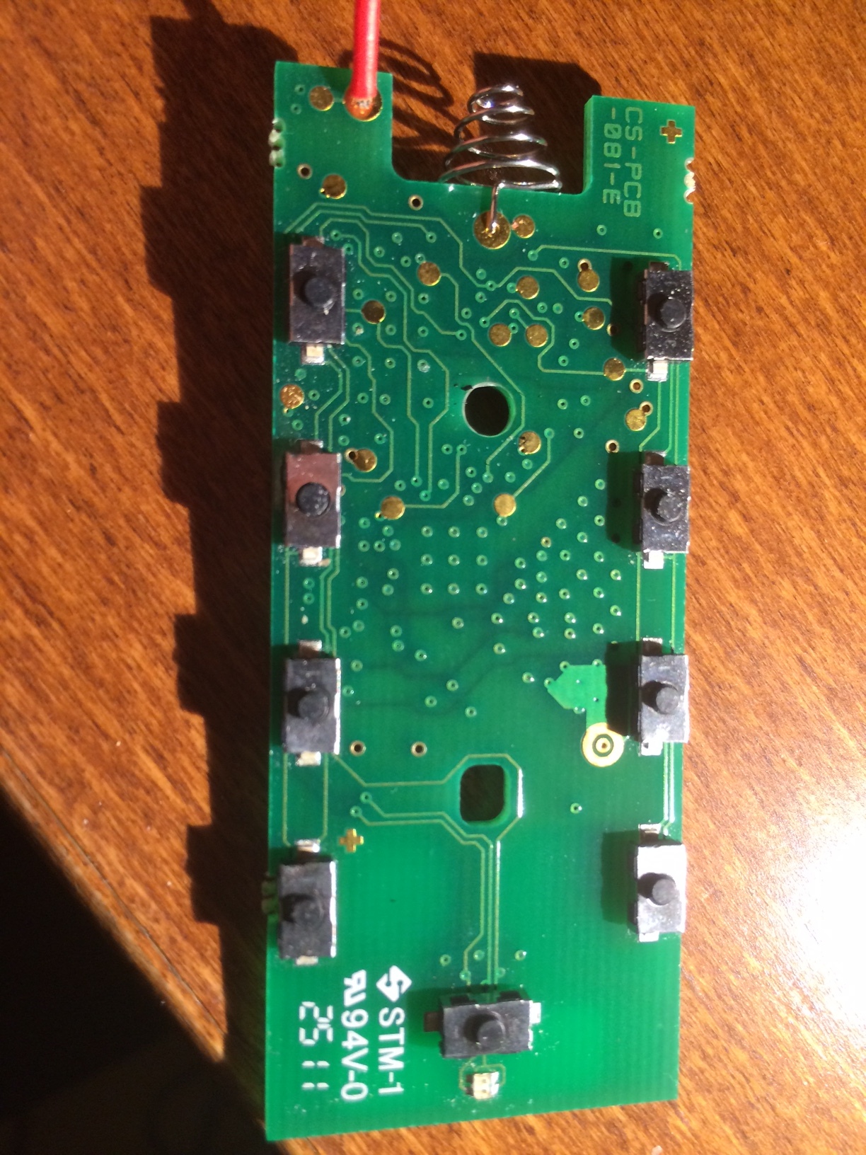

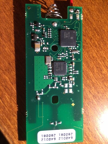

OK, today I got the tools needed and opened the remote.
(Obs, there is something wrong with this, it's not working, but that was from before I started messing around 8)
There are two chips on it.
"CC1020 TI 17G M2FO G4"
"18LF452 -IML 1128GS4"
Images of front and back is attached.
Images didn't upload, can you try attaching them again
first
second:
