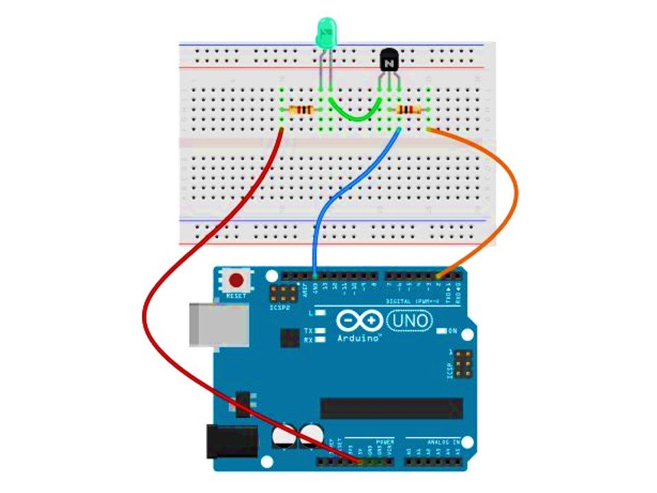

I want to control 2 or 3 LEDs via switches on the Arduino cloud, using my r4 wifi and breadboard etc.
I wonder if anyone can direct me to a very basic project that will acheive this? I need the wiring diagram, and steps on how to setup and control the switches etc via the cloud. Any help would be much appreciated.

With the Arduino UNO R4 WiFi, you cannot draw more than 8 mA of current from any digital output pin, so you will need to switch the external LEDs using transistors. Here is an example:

Why not just use appropriate current limiting resistors on the LEDs instead? Modern LEDs are plenty bright with 8 mA.
Sounds reasonable, although we don't know if OP plans to use a single pin to control multiple LEDs...
Also, although Arduino UNO R4 WiFi datasheet says that 8 mA current draw is safe, Table 2.6 in the RA4M1 data sheet seems to suggest that the maximum permissible output current per pin may in some cases be only 4 mA.*
*Disclaimer: It is entirely possible that I have not correctly understood the table in the RA4M1 data sheet, in which case a correction/clarification would be appreciated.

So @ardant, what you're gonna have to do is more or less copy the mechanism that is already in place for the LED_BUILTIN
This means that you'll have to create a new Cloud Variable (let's call it "my_state") , that you will link to your switches that you'll also add on your dashboard.
Then on the code side, you have to copy/paste /adjust the pinMode instruction to set the pin you chose for your external LED as an output.
And then in the loop (right after ArduinoCloud.update() for example, you could have your new digitalWrite(your_pin_led, my_state) instruction.
However, careful with the current you're going to make go through your Arduino! Don't go over 8mA.
If you don't have the good LED (or not enough brightness with a high value resistor) then you'll need to use a transistor or whatever to give more power to the LED
