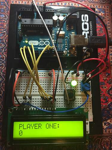

I am very new to programming, and have spent all day trying to figure out how to do this. Any help would be appreciated!
I'm trying to get my LCD to display a score, and have that score increase in value when a Button is pushed. I cannot find a single clear tutorial or example of this anywhere on the internet...
added a pic of my LCD scoreboard so far,
Here's my code, and a lot of the stuff I'm missing is in comment caps:

Looks like you are on the right track, neat wiring.
Here's the image attached to the top post.
How to insert an uploaded image.

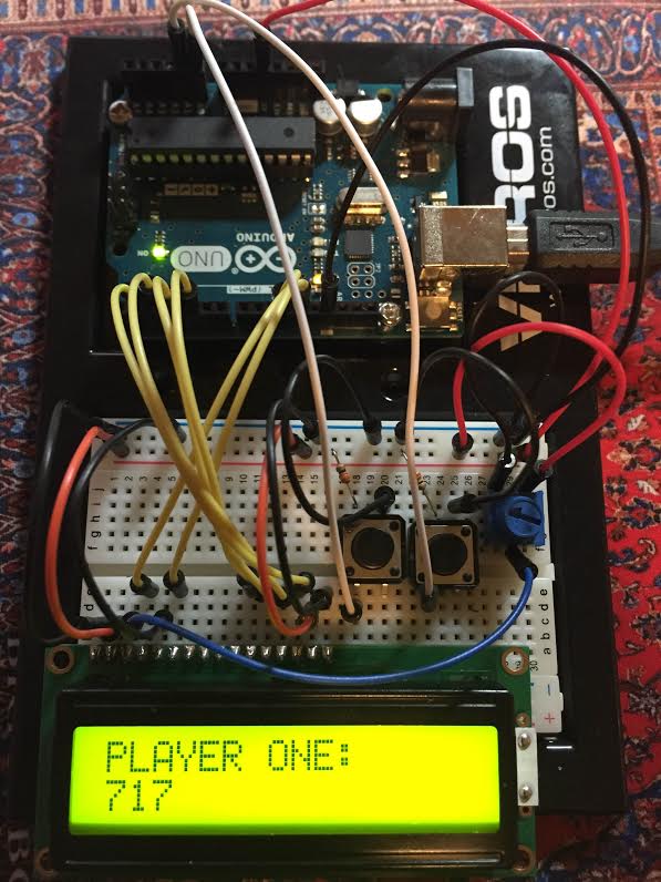

It works!
I'm sure this is not the most elegant solution to the sketch but it currently works.
Button A gives me 1 point when pressed,
Button B gives me 100 points when pressed.
Here's my code, and a pic of my wiring:

Good start!
Now it's time to master some techniques:
Learn to use the best type to save RAM
unsigned int Score = 0; // scores don't usually go negative.
byte a = 1;
byte b = 100;
delay(500); // this freezes your sketch for 1/2 a second which is almost always not what you want.
Better look into blink without delay, an example comes with the IDE.
pinMode(A0, INPUT_PULLUP); // is usually done so you don't need a physical PULLUP resistor.
Also the sooner you learn about de-bouncing switches the better off you will be.
It looks like you are using delay(500) to give you time to release your finger, and count only once. Not a good permanent solution.
The next step for you is to remove the delay and instead either use edge triggering as above, or if necessary, use button debounce code.

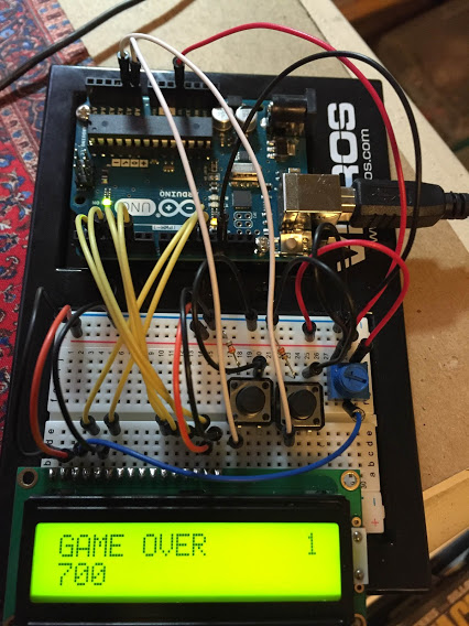

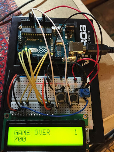

ok here's a weird behavior I cant figure out.
I want the game to start with 5 balls.
When a button is pushed you loose 1 ball
when (balls < 1) I want "GAME OVER' displayed
So this all works great, except when "GAME OVER" Appears there is still a 1 where the ball credits are displayed. I would like that to go away. I'm not sure why it's there.
Even weirder, if I hit (LOST BALL) again after game over appears, I get 6 credits. It remains at 6 no matter how many times I push it after that.
Here's the code and a pic of my "GAME OVER" state with the 1 unwanted credit:

When <1 clear the screen.
You better learn to handle bounce in your switches.
I don't recall how your switches are wired but you may need INPUT_PULLUP in pinMode.
