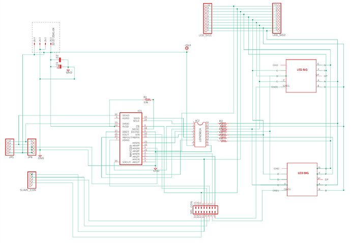

Hi
Thanks for every one for your immense support on my post and code is compiled with zero errors.
can any one just tell me all LED' s are continuously off with this program, need suggestion on this.

Hi
Thanks for every one who replied my post and help to build
, actually i have setup a score board circuit by making pcb for 7 segment display, i will just brief my circuit and i will post the program and schematic also
i have used 2" 7 segment display and totally Six 7 segment display's
and used two max7219 devices to drive the display's.
i have used three 7 segment display's for one max7219 and drive a display and used 2981 ic 8 channel source driver for driving a 2" 7 segment display.
since display need 20 mA for each segment so one 7 segment display need 140 mA
of current.
Still now circuit not working, the program which i have attached, same i have uploaded program to the Arduino Uno which i have attached and all display's already switched on lights up with a half bright(where it suposed to be without on when no signal is given) below picture can see.
Please can any body suggest.
type or paste code here

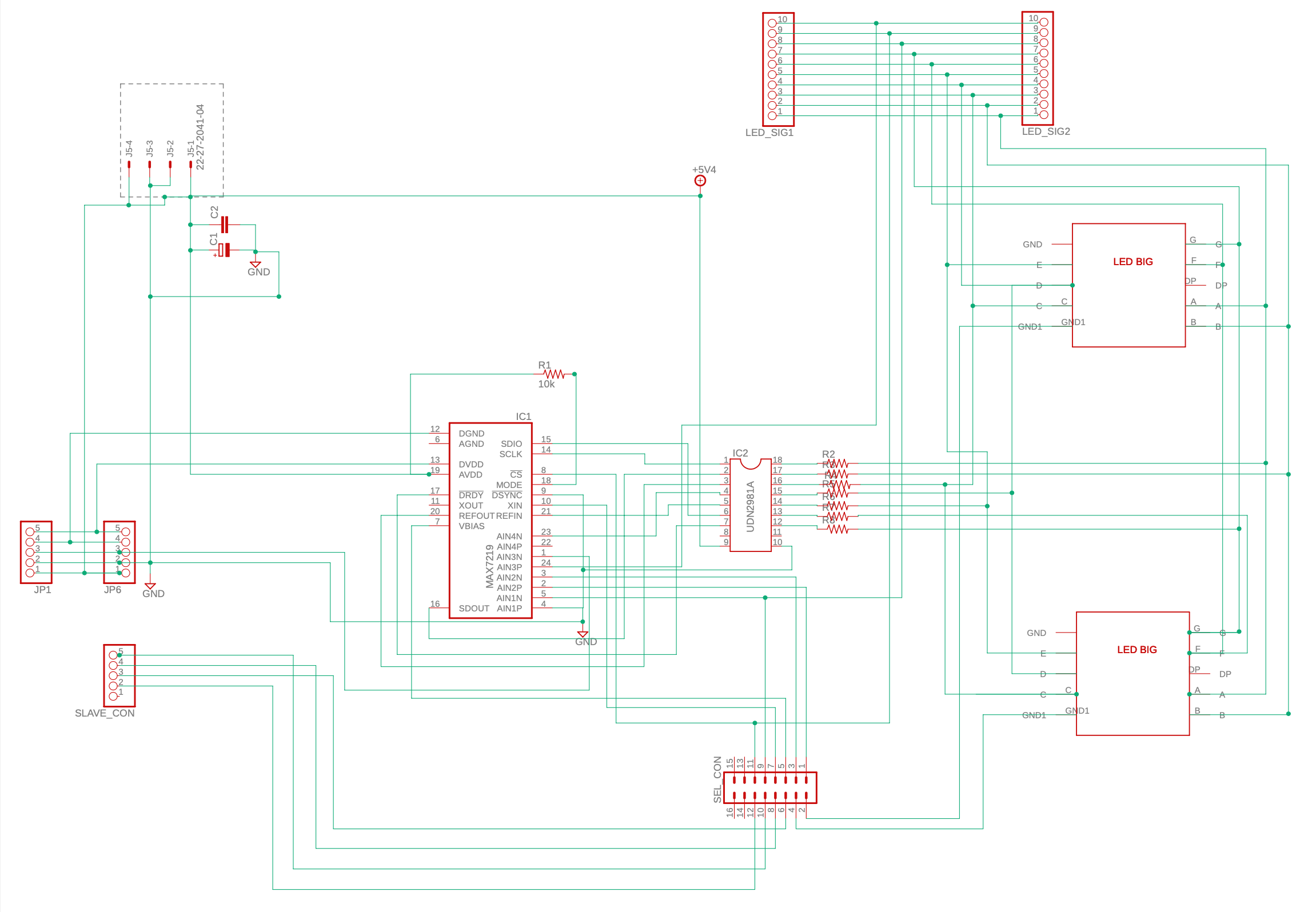

don't understand why SDIO (15) and SCLK (14) are connected to the UDN2981 driver and not to the SPI interface pins of the processor
the circuit for those who want to see it directly in the forum
