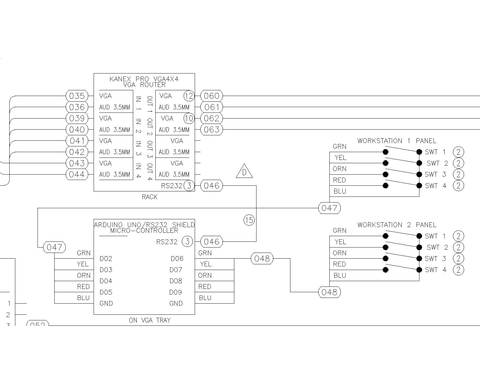

I need to control a device that is basically a video matrix its got 4 inputs a...d and 4 outputs 1..4, it wants to see ascii commands in the form of inputoutput so C2 would send input C to output 2, then the device makes the switch and sends back a string "input A to output 2". I made a very rudementary program that polls the digital pins which have buttons that provide a closure and makes the switch accordingly, the program worked fine for a couple of days, then it stopped working, the rs232 shield from cutedigi stopped working, the tx led in it lites up very dimly, it use to be bright when it was working, i tried doing the sample pc-pc program and it still doesnt work the board burned up, I was hoping someone can look throught this very simple code and tell me if something I am doing or not doing caused the board to burn up, something like ignoring the feed back

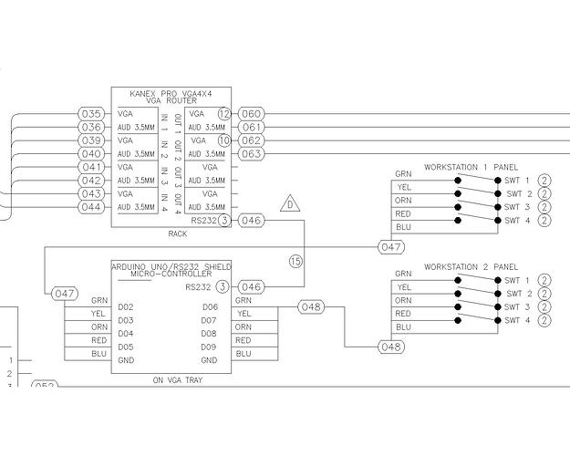

Most probably this isn't a software problem. Please provide a wiring diagram and links to the involved hardware.
vga router
rs-232 shield
http://www.cutedigi.com/arduino-shields/rs232-shield-for-arduino.html
buttons
VGA4X4SW-Manual BW[1].pdf (1.07 MB)
How do/did you power the Arduino?
During that LED glimming, can you measure the voltage between GND and 5V pins on the Arduino board?
