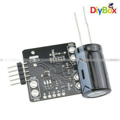

This is slightly off topic..... But.
I bought a few solar lights at Lowes. They are usually a joke, but this one intrigued me because of the size of the solar panel and that it was surprisingly bright, which told me that the LED was drawing considerable current.
https://www.lowes.com/pd/60LM-Solar-Spot-Light/1002689960
Upon opening, I found a controller board and an 18650 battery. I replaced the controller board with a LiPo charger board.
As an experiment, I added a Wemos D1 Mini and a ds18b20 temperature probe. The Wemos was waking from deep sleep every five minutes and publishing the temperature over MQTT.
After a days charge, I moved it into the basement. It kept publishing the temperature for five days. It was still powering the Wemos after five days when I put it back in the garden, so I am sure that it would work even in the winter.
@SteveMann, I'd like to know what your experience has been with that MCP73871 module. The chip seems perfect for solar charging because it even includes the load sharing (aka power path) function so the solar panel can directly power the load when the sun is shining, while independently charging the battery. But Andreas Spiess reviewed a number of chips for solar charging, and didn't like the MCP73871 - apparently he couldn't get enough power out of it. What's been your experience?
And I'll just agree with the idea that powering something with solar alone means it probably shuts down with every passing cloud.
My experience with this board is limited to my post above. It was just an experiment to see if the solar panel would keep a 16850 battery charged while powering up a Wemos D1 Mini every 5 minutes. One day of charging kept the Wemos running for five days in my basement. It probably could have run longer- I did not wait until failure.
