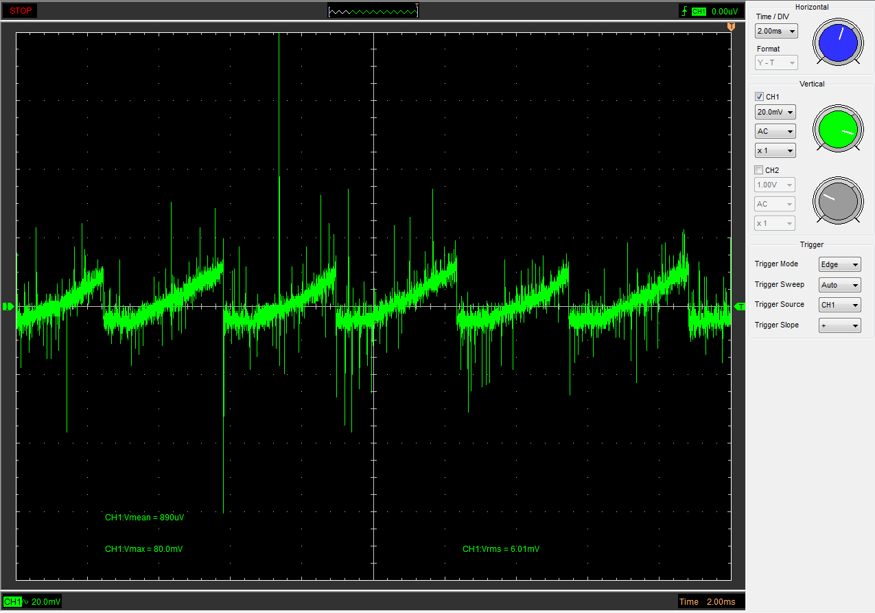

Kamelryttarn, can I suggest you comment out the enable,LOW between the step changes.
Just change steps without pauses.
At the moment when you disable the driver you turn off all the outputs to the coils effectively adding dead time to the stepper motor.
The L298 will be able to handle the stepping and load.
This will probably increase your speed.
Tom....

Removed all unecessary delays and the switchin of the enable pins, but it doesn't work much better so I hooked it up to my borrowed logic analyser and saw something weird.
The high pulse on pin 8 is 2.07ms and the low pulse on the same pin is 2.28ms.
The high pulse on pin 9 is 2.06ms and the low pulse on the same pin is 2.29ms
The high pulse on pin 10 is 2.29ms and the low pulse on the same pin is 2.06ms
I believe this might have something to do with the fact that I feel I get better performance when I make use of the enable inputs and switch the pins during a small time frame when the outputs have been disabled.
Here is a screenshot of the oscilloscope readings on the 20mOhm shunt resistor. It seem to be peaking at 80mV which would mean about 4A.
I made a lot of interesting observations yesterday when I hooked my circuit up to a variable power supply and was able to adjust the motor voltage as I was changing the speed with the potentiometer and also upload new code to my arduino.
I was able to get a fairly high speed from my little stepper and the L298 when I was pushing my power supply up to its maximum 24V, but things where starting to run a bit hot. I do not have any heatsink on my L298 so I decided to back of a bit when I couldn't keep my finger on it.
Driving a stepper at a large range of speeds with the L298 without any kind of voltage or current control seem more or less impossible. I could get high speed, but the current running through the driver and motor got way to high when I brought the speed down and adding delays where the motor was essentially not driven didn't help much. I noticed that for every speed setting there was a tight voltage window where the motor was running incredibly smooth, but when I went above or below that voltage the motor began to vibrate a bit. When running higher I assume the motor had time to stop and hold at each step before it was time for the next step.
I have learned a lot about steppers these last few days, and I think I will probably try another driver and see how it compares to the L298. I still think L298 is a very good choice for steppers with the arduino. It is easy to understand what is going on, and the current sens pins makes it very easy for those who are interested to hook up a shunt resistor to a scope and monitor what is going on with the motor coils. I used a USB oscilloscope and had some ground issues that account for most of the noise you can see on the screenshot.

First of all I wanted to learn a bit more about stepper motors.And second, my application is somewhat unusual for a stepper motor. I want to regulate the speed with a potentiometer and get it up to a fairly high speed and keep it there for maybe 48 hours or more. Not exactly what one would normally use a stepper for. Hence all libraries and drivers are not optimal, even though some are probably useful anyway.
When I raised the motor voltage on the L298 from 5 to 12V I could reach a delay time of just over 900 us. I have a shunt resistor to be able to measure the current through one of the coils of my motor, and on the oscilloscope it looks like the current goes down with increased speed just as I was expecting. Also when I run it at the highest speed my setup will allow, nothing gets hot as it used to with 5V and low speed.
