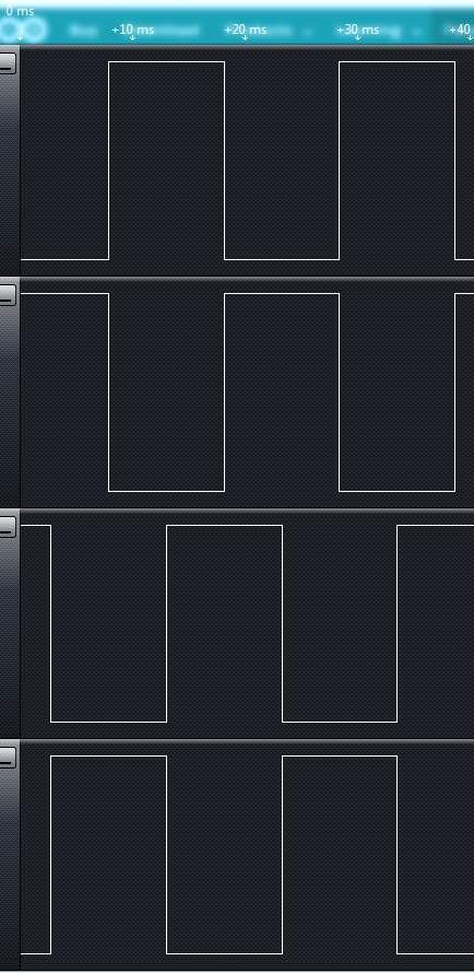

I have borrowed a logic analyzer to better understand the original, working code.
From the printout I can see that the original example sequence (wich works for me) is:
PIN 8 9 10 11
SEQ1 H L L H
SEQ2 H L H L
SEQ3 L H H L
SEQ4 L H L H
I will give this a try and take from there. The original code does not make use of the enable-inputs so these are the only pins used.

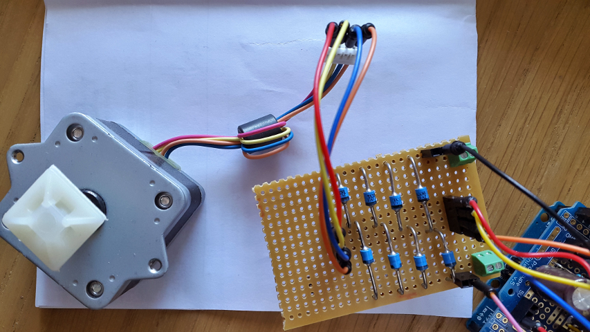

Can you please post a copy of your circuit, in CAD or a picture of a hand drawn circuit in jpg, png or pdf?
Tom.... :slight_smile:

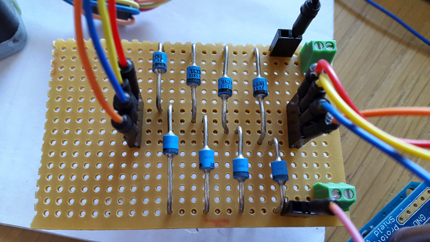

I'll do my best to provide pictures and explanations to my wiring setup. I have soldered the L298N to a prototype shield and put the diodes on a separate piece of PCB.

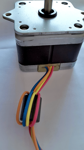

Here are pictures of the stepper motor to confirm mine only has 4 wires.

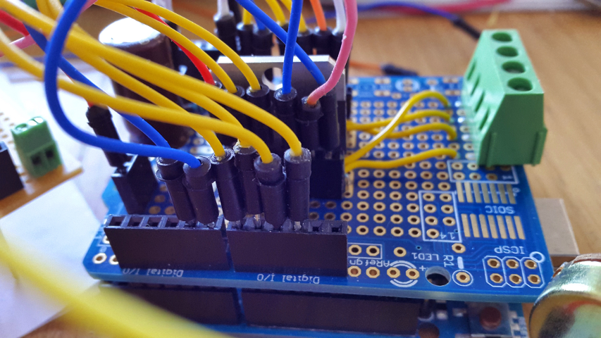

Here are some pics of the setup. Pins 8 through 11 are the yellow wires that goes to the 4 inputs of the L298N chip. Pins 6 and 7 are connected to the enable inputs of the L298N, but for those who only wants to test the example code provided in the Arduino IDE installation these enable inputs should be directly connected to the 5V rail (logic HIGH) otherwise the motor will now turn.
The white wires are sense-connections on the L298N where I had my shunt resistor connected. I have replaced it with a wire for now.
The setup is pretty straight forward and the L298N is pretty easy to understand as well as connect and solder yourself, unlike a lot of the "better suited" stepper motor drivers that are SMD.
A few more pics. I put a large connector where I could attach motors or what-not but I ended up connecting my stepper in the header I soldered close to the L298N instead
Here is the diode board and the connections to the motor.
