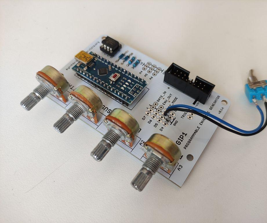

One more thing: it occurs to me that an envelope generator might be a useful solution.
