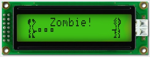

How about something like this ![]()
Gun might want to be a bit higher though ![]()
Exactly what Beige just drew! ![]()
Would be mainly graphics, the gameplay could still be the same as you have now.
Zombie appears: draw zombie
Zombie dies: don't draw zombie
Press button and zombie is alive: display bullet and move it to the right fast
Walking speed of the zombie could be related to the time you have left
