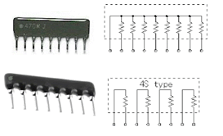

Aren't those resistor arrays already bused? Ie one pin common to all resistors, and 8pins for the other ends? It doesn't seem to make sense to be grounding the unconnected ends...
I thought that the whole point of a resistor array was that it has only a single common connection to the resistors so I do not understand your question
For example, for an 8 resistor array there will be 8 resistor connections and a single common connection

The array will be like this internally

Use a DMM and check how it is internally connected.
Tom.. :grinning: :+1: :coffee: :australia:
Hi @TomGeorge ! Thanks for this info! I will check the component :slight_smile:
Usually the pin marked with a white blob (the left hand one in @TomGeorge diagram) is connected to earth. It will not do any harm to check.
