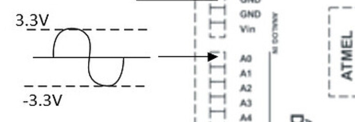

Thank you for the information, I have updated the diagram to show the GNDs connected together

You do realize the A0 must always be above 0V?

Apparently he does not realise or understand this, so rather than asking a question about it, @due_noob has chosen, very unwisely to ignore you, and as a result has probably burned out the Due's analogue input pin.
@mrburnette Yes I knew I could only put 0 - 3.3V on the ADC, it was a poor drawing on my part. That is what the sine wave will look like after it has come out on the DAC and gone through a level converter that is isolated from the Arduino's I/O
