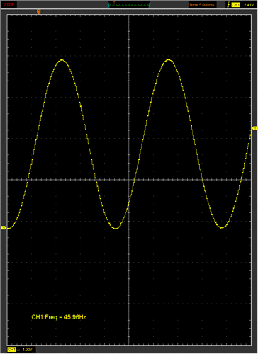

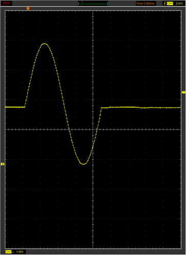

When your sine wave stops and resumes, it doesn't pick up where it left off, but where it would have been if it hadn't stopped. So it looks like your code keeps running, but the DAC output stops updating for a while.
Did you leave the /LDAC pin floating?
Yes all unused pins are floating. Excellent point. I will keep it low and see what happens. Thank you!
[edit] It now works as expected. The problem was the latch pin that should be kept at logic level low (ground) if the DAC is to update the analog output level on each rising edge if the chip select pin (CS)

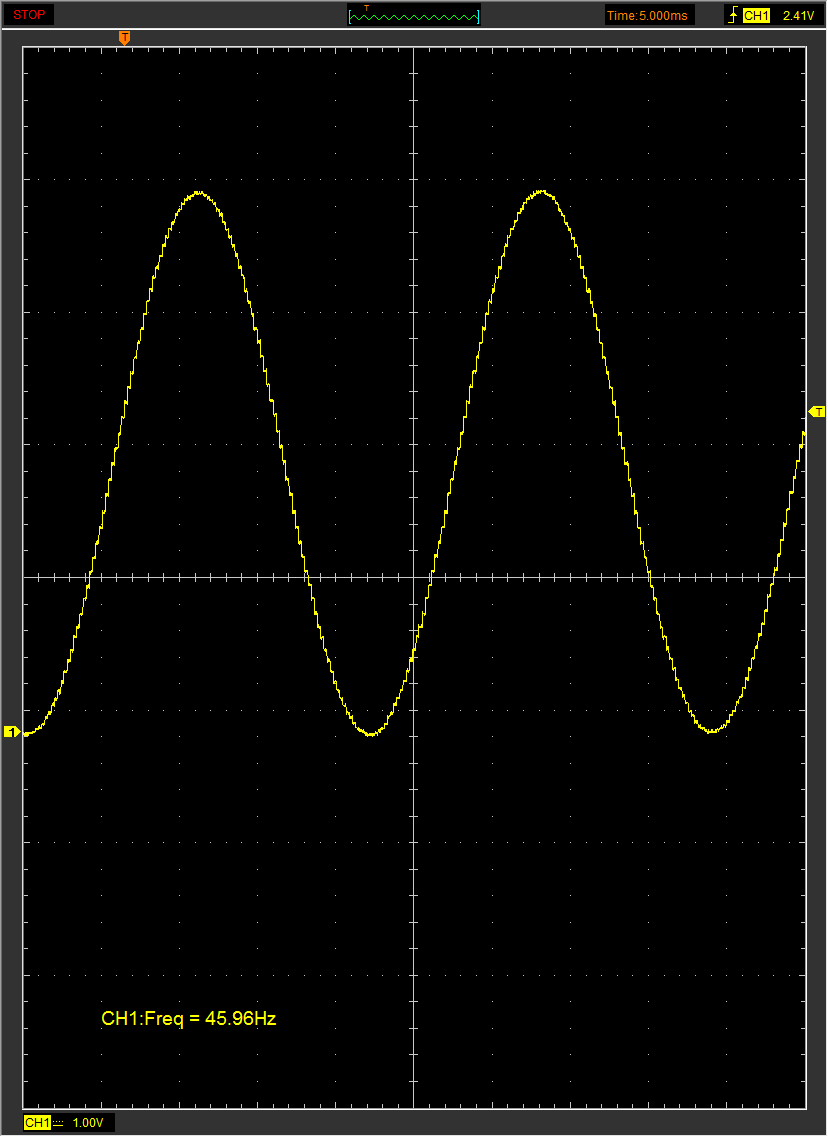

I gave transfer16 a try today and it went very well. The code went from almost 70% of the amount available on my UNO to 7% !!! And that includes a library that wasn't there before.
The frequency went from 45Hz to 630Hz and there are still possible improvements to make. (I still use digitalwrite for the chip select).
This has been extremely educational despite the disheartening comments. We all have different levels of experience and I wouldn't have gotten this far and learned so much if it wasn't for my initial and very crude bit banging approach. It gave me a very good understanding what SPI actually does and it did work as expected, albeit a bit slow.
