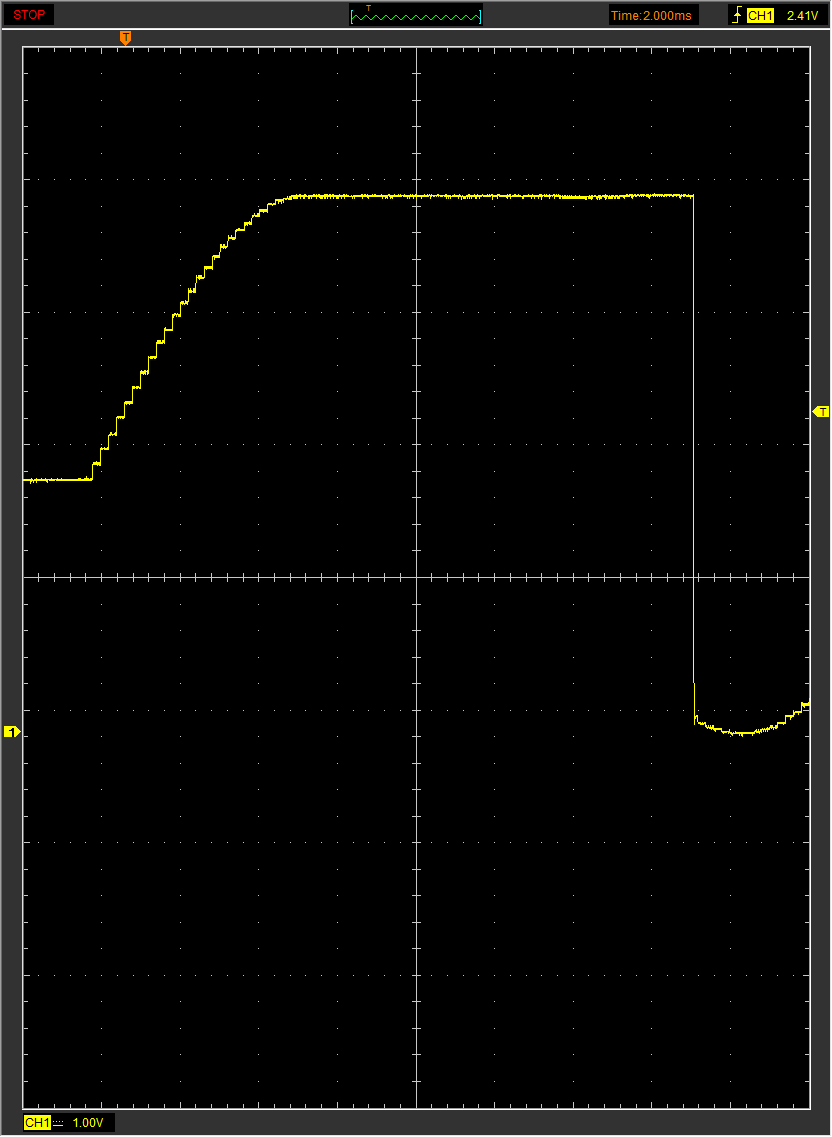

I was looking for a way to create a simple sine wave generator with an Arduino today and found the MCP4801 DAC. When I did a search on the forum I discovered this thread.
My code so far only contains the decimal value 128 in 8 bit mode so my code is intended for the MCP4801 but one could easily adapt it for the 10 and 12 bit DAC chips as well but I suspect the sine wave code will be very big.
I used the sine wave table generator found here to create a table of 127 steps with a maximum value of 255 and then I used the DEC2BIN function in google sheet to convert it to binary values.
When I transferred the code to my Uno and hooked it up to my logic analyzer it looked like really good so I think I will order a few DAC chips and start experimenting.
I realized I couldn't use SCK as integer name because it is already available/used for pin 13 so the clock will automatically be on pin 13 when using the name SCK.

kamelryttarn: Trying to bit-bang SPI as you’ve attempted will result in extremely low output rates, a few kilohertz will be the limit on a 16MHz AVR.
To get the full audio range, you will need to learn how to use hardware based SPI transactions. Examine the libraries, they all use hardware based functions in the core Arduino SPI library. Hardware SPI is far easier to implement than crude, brute force bit-banging and several orders of magnitude faster.

Not entirely sure if I should post this in this thread or start a new one, but here is an update.
I finished the bit banging code for the MCP4801 today and uploaded the sketch to a board and gave it a try but I can not explain the odd waveform in the oscilloscope.

I put a 10 000 millisecond delay at the beginning of the loop to get a more clear picture of the problem but unfortunately it did not help much. I have attached a few different oscilloscope screenshots. I can't understand why the sine wave does not start at decimal value 128, continue with a rising wave, going down to zero and continue up again to decimal value 120.
Looks like something is hanging ..... or put on hold for a while, before continuing again. You should check out what happens.... like your functions seem to 'initialise' the chip at the beginning. Maybe associated with that kind of thing.
When your sine wave stops and resumes, it doesn't pick up where it left off, but where it would have been if it hadn't stopped. So it looks like your code keeps running, but the DAC output stops updating for a while.
Did you leave the /LDAC pin floating?
No you didn’t, that code must get a prize for the absolute worst code ever posted here. Have you never come across a “for” loop or an array?
Basically it is a mess that it unreadable. Typical of the copy and paste generation. If you had to type all that at a terminal you would soon get the incentive to learn.
