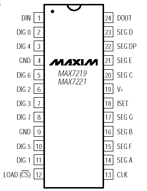

PIN Max7219
1 = E 21
2 = D 23
3 = DP 22
4 = C 20
5 = G 17
7 = B 16
8 = common 6
9 = common 11
10 = F 15
11 = A 14
12 = common 2
DIN - 12
clock - 11
load - 10
max - 4 & 9 ground
max - 19 power
that's how i have it wired
Please fix your wiring then.
do i have any of it right? took me awhile to wire it up and i don't read diagrams like that well..
the one i go by is
Do you have:
Arduino-D13 to MAX7219-13?
Arduino-D11 to MAX7219-1?
Arduino-D10 to MAX7219-12?
If you don't have those control signals connected, the MAX7219 is not going to work with the code provided.
yes and still nothing..
also as far as i can gather this segment is an LDS-3361 AX/BX
datasheet: MAX7219datasheet
and as far as i can see, i have my wiring right.. maybe i'm wrong but i don't believe so
Is yours the AX or the BX?
You said back in reply #12 "3bit Common Anode Digital Tube 0.36in. red LED" which would be BX, which isn't going to work.
Your big picture a few posts back also did not show any capacitors or a resistor from MAX7219 pin 18 to +5, 22K to 33K. Those are also needed.

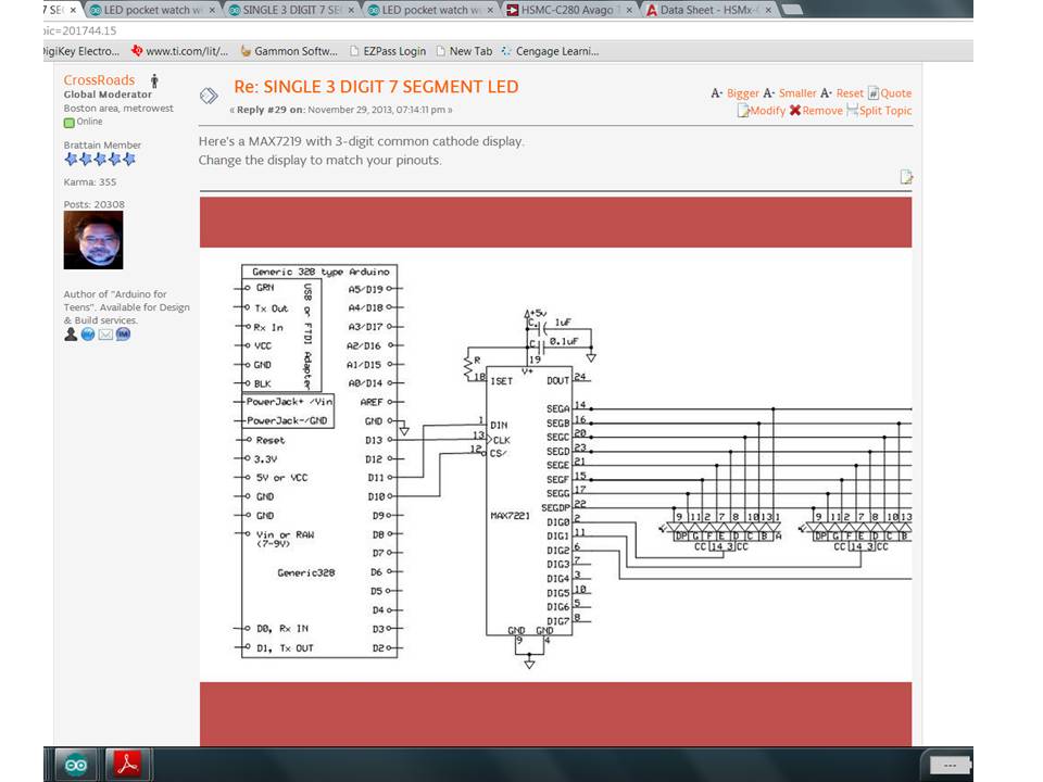

The photo you took earlier only showed the breadboard, and not how it was connected to your Arduino.
cupstacker:
and yet to see someone confirm the wiring i have is correct or incorrect.
Give us a complete photo of your setup and we may be able to do this.
cupstacker:
as far as capacitors and resistors i haven't used any simply because i do not know where they go or how many and nobody showed me that.
I linked this page before. Did you visit it?
Here's a diagram from that page:
is it really that complicated to get this single 3 digit segment display to work?
It shouldn't be. Since you have worked out the pin-outs can you use a meter, or a 5v power supply and a resistor (like 220 ?) in series, and work out which way around the LEDs are. You know the common pins (8, 9, 12). Are they anodes or cathodes?
tons of "experts" on here and we can't get this display to work?
"We?". If you expect help you need to do better than a graphic with a few boxes and coloured lines. We aren't mind readers, experts or not. Draw exactly how you have wired it up, using pencil and paper if you have to, and scan it it. And/or take a photo. And post the exact code you are using. A one-line bug in the code, or a single wire in the wrong place can do it.
