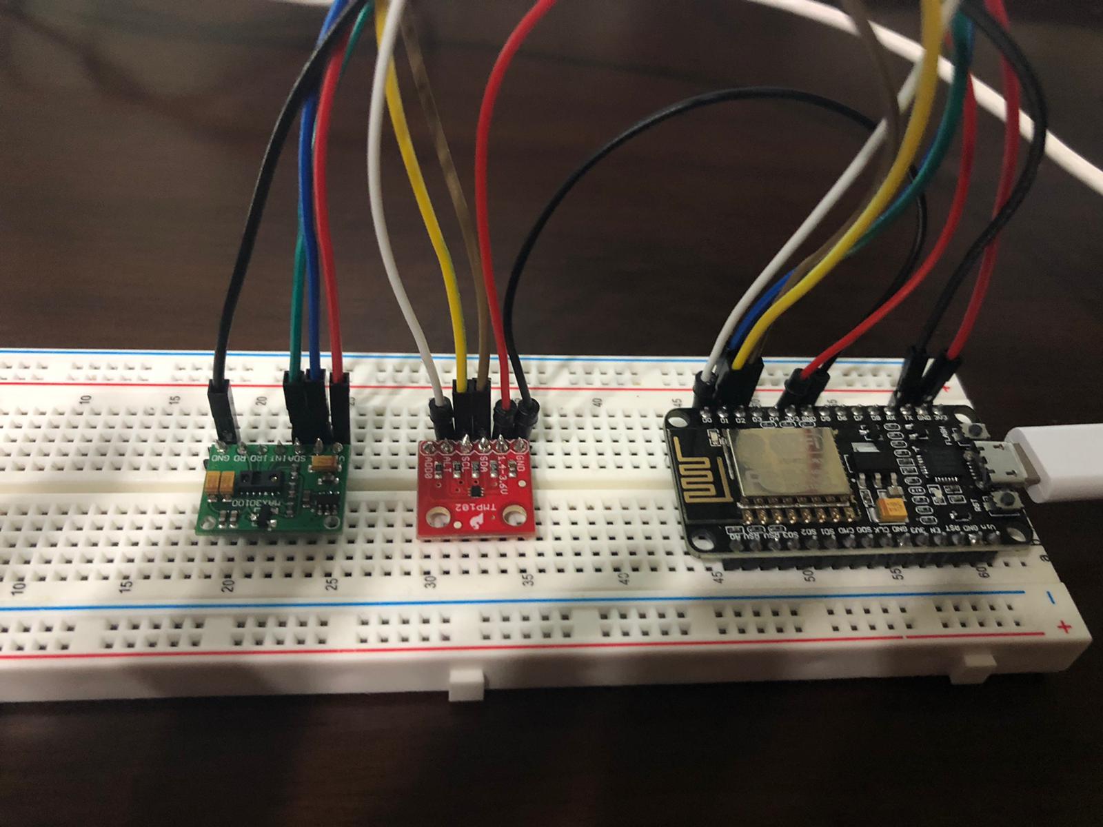

I am using the MAX30100 and Sparkfun TMP102 sensors with a Nodemcu esp8266. I want to run both sensors at the same time, so I have merged the two example codes for those two sensors. There is an issue with the program though, and I am unsure how to fix it. The individual example codes work fine, but there is an error with my merged code. How can I fix the merged code I've created?
Here are the connections for the sensors to the Nodemcu:
TMP102:
3.7v ==> 3v3
Gnd ==> Gnd
SDA ==> D2
SCL ==> D1
ALT ==> D0
MAX30100:
VIN ==> 3v3
Gnd ==> Gnd
SDA ==> D2
SCL ==> D1
Pictures of circuit

With the sensors wired as is and the I2C scanner code is ran, what are the results?
It hasn't compiled because there are some errors in the code, I'm not sure how to fix them though. Here's a picture of the errors that pop up

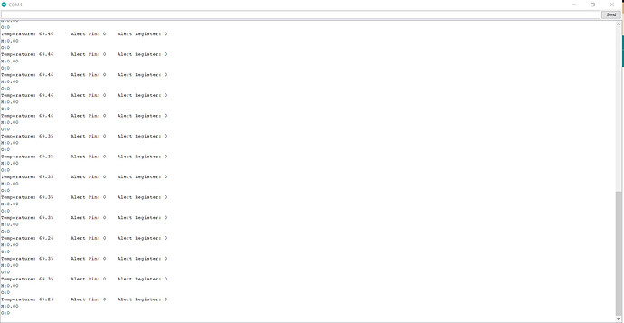

Thank you, now the code is compiling. Although, when I run the code, only the values from the TMP102 are getting displayed on the serial monitor. Am I missing something from the code?
Heres a picture of the serial monitor when I run the merged code
It's supposed to display the values from the Tmp102 AND the MAX30100.
As DaveEvans suggested, remove that delay(1000) and move the temp code inside the if() statement.
Just before tsLastReport = millis();
Because that if statement already has a 1000ms reporting/waiting time.
You can wake/sleep the temp sensor also inside the if() statement, just before and after the temp code.

13:23:56.838 -> --------------- CUT HERE FOR EXCEPTION DECODER ---------------
13:23:56.838 ->
13:23:56.838 -> ets Jan 8 2013,rst cause:2, boot mode:(3,6)
13:23:56.838 ->
13:23:56.838 -> load 0x4010f000, len 3460, room 16
13:23:56.838 -> tail 4
13:23:56.838 -> chksum 0xcc
13:23:56.838 -> load 0x3fff20b8, len 40, room 4
13:23:56.884 -> chksum 0xc9
13:23:56.884 -> csum 0xc9
13:23:56.884 -> v00043fc0
13:23:56.884 -> ~ld
13:23:56.931 ->
13:23:56.931 -> --------------- CUT HERE FOR EXCEPTION DECODER ---------------
13:23:56.931 ->
13:23:56.931 -> Exception (28):
13:23:56.931 -> epc1=0x40201db6 epc2=0x00000000 epc3=0x00000000 excvaddr=0x00000000 depc=0x00000000
13:23:56.931 ->
13:23:56.931 -> >>>stack>>>
13:23:56.931 ->
13:23:56.931 -> ctx: cont
13:23:56.931 -> sp: 3ffffde0 end: 3fffffc0 offset: 0190
13:23:56.931 -> 3fffff70: 00000000 feefeffe feefeffe 40201db4
13:23:56.931 -> 3fffff80: 0001c200 3ffee730 3ffee538 40201ff0
13:23:56.931 -> 3fffff90: 3fffdad0 3ffee730 3ffee538 4020107b
13:23:56.978 -> 3fffffa0: feefeffe 00000000 3ffee784 40202d5c
13:23:56.978 -> 3fffffb0: feefeffe feefeffe 3ffe85d8 40100b55
13:23:56.978 -> <<<stack<<<
13:23:56.978 ->
13:23:56.978 -> --------------- CUT HERE FOR EXCEPTION DECODER ---------------
13:23:56.978 ->
13:23:56.978 -> ets Jan 8 2013,rst cause:2, boot mode:(3,6)
13:23:56.978 ->
13:23:56.978 -> load 0x4010f000, len 3460, room 16
13:23:56.978 -> tail 4
13:23:56.978 -> chksum 0xcc
13:23:56.978 -> load 0x3fff20b8, len 40, room 4
13:23:56.978 -> chksum 0xc9
13:23:56.978 -> csum 0xc9
13:23:57.024 -> v00043fc0
13:23:57.024 -> ~ld
13:23:57.071 ->
Code tags?
I'd load up the ESP Exception Decoder into the Arduino IDE to decode the error message into something a bit more useful.
I'd comment out every line in the loop() function. Then I'd comment every line in setup(). Then upload, does it produce the error?
No. Uncomment a few lines in setup, does it make error after upload? Yes. No.
