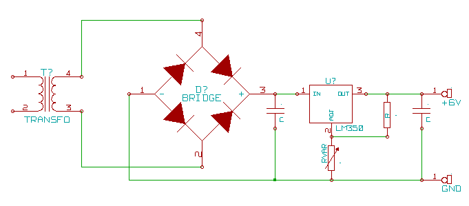

Hi Folks.
Yeah, I'm still around. Just have a lot of distractions these days. Anyways ...
The 6V 2A switching supply for my Pila IBC charger went bonkers on me. I use this thing every day. I have some backup in place, but need to get it replaced. So, of course, I'm thinking of building one, instead of buying. Yeah, likely not cost-effective. But I'll feel better about the reliability of a plain linear supply, vs. a random wall wart switcher I find on the web.
Not sure the LM350 regulator is the best choice, but I'm sure it'll work, and it has plenty of headroom. (I note that the Pila charger itself calls for 6VDC 2-3A, so I'm not sure why they supplied a 2A supply.) I can choose caps from the datasheet, I think, and toss in a fuse and some protection diodes, but below is the basic circuit.
Question is, how do I size the transformer. I've killed about an hour looking for a decent tutorial on the web, and come up empty. I'm thinking 15W 12V secondary, but I could be way off. I'm figuring ~2V drop on the regulator, and 1.7 for the bridge, giving 9.7V, and then just adding some headroom. But some of what I've read indicates I need to account for ripple voltage, which, now I think on it, probably influences the specs for the filter cap coming after the bridge too.
Pointers to good tutorials, references, etc. appreciated.

The biggest concern I have is with the power dissipation in the regulator. I'm pretty sure you can overheat the thing (depending on the heatsink) at less than 3 Amps when there's more than a couple of volts dropped across the regulator.
It's been a long time since I've calcuated ripple. The voltage regulator will knock-out the ripple, as long as the ripple doesn't exceed the point where the voltage regulator drops-out. So, I usually just use a capacitor that's 1000uF or more, one that's available, and one that will fit physically. (A higher voltage into the regulator will tend to minimize ripple problems, but more it's more power/heat in the regulator.)
12VAC is plenty for a 6VDC supply. I think you're forgetting that the peak AC voltage is about 1.4 times the RMS. At 12VAC your capacitor will charge-up to about 17V minus the diode drops. (I'll usually use a 12V transformer for a 12V power supply.) And at no-load, the transformer will probably put-out more than 12VAC. If you can find a 9V transformer, that should be enough.

A few points:
  1. VA rating of a transformer is not the same as Watts output. Because of the pulsed nature of the current flowing through the bridge rectifier, you need a transformer with a significantly higher VA rating than is implied by the current you will be drawing. If you want to supply 2A and you use a 10V transformer, I suggest at least a 30VA transformer.
  2. If the voltage drop across the regulator at full load is larger than you want, you can use a smaller capacitor to give a larger ripple voltage and hence a lower average voltage across the regulator. A smaller capacitor also helps with reducing the RMS current drawn from the transformer, and hence keeping within the VA rating.
Example:
10V transformer, 14.14V peak, less nearly 2V in the bridge rectifier gives 12V. Rather high for your 6V regulator, so design for 4V ripple @ 2A load, hence minimum voltage drop across the regulator will be 2V (which should be enough) and average will be around 5V @ 2A load. hence 10W power dissipation, which isn't too difficult to get rid of unless the power supply has to fit in a confined space. Capacitor to get 4V ripple will be somewhat less than (2 * 1/120)/4 F = 4200uF. I suspect 3300uF will be just about enough.
Alternatively, use an 8V transformer such as http://www.digikey.com/product-detail/en/VPP16-1900/237-1076-ND/242520 and design for not more than 1V ripple.

Well, I finally built this thing. With a 2A load, peak V across a 22000uF smoothing cap is 8.35, with 20mV ripple. (This measured on the landlord's Tektronix o-scope) Output voltage is very stable.
However, the regulator gets quite hot. Landlord is of the opinion the regulator will fry itself. According to the datasheet, it has "full thermal protection", but I haven't let it run to see whether it shuts itself off. Don't have a thermal probe, so I don't know how hot it is, so I don't really know whether it's too hot.
Just pondering where to go from here. I can try a smaller smoothing cap, but if I'm reading the datasheet correctly, I don't have much room to spare with the dropout voltage. I'm considering:
  • Different model regulator
  • Larger heatsink
  • Switch to a LM350 in a TO-3 case
I'm leaning toward the LM350 in a TO-3 case. I have a working circuit. I can clip off the existing regulator, cut a hole in the case, mount the TO-3 externally on a big square of aluminum, and wire to it from the clipped off leads. This appears to be the path of least resistance.
I'm thinking a different regulator will still require a larger heatsink anyway. There is some room inside my case for a larger one, but it'll be a bit tricky.

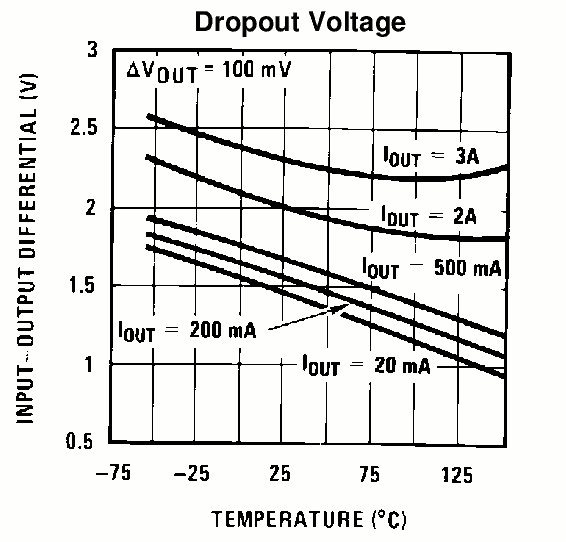

I will add that upon looking again at the datasheet, I'm certainly not using the dropout voltage drawing correctly. So, I think my best course is to try smaller caps until the output sags. And the LM350 in a TO-3 is a spendy item. STMicroelectronics has an LM350 for a lot less. I just wonder how close it is to the TI in characteristics.

The TI datasheet I have makes no distinction between the T and the K. Here's what seems relevant.
These specifications are applicable for power dissipations up to 30W for the TO-3 (NDS) package and 25W for the TO-220 (NDE) package. Power dissipation is ensured at these values up to 15V input-output differential. Above 15V differential, power dissipation will be limited by internal protection circuitry.
Well, maybe it isn't the right datasheet, but I hope I can trust Digikey to provide such. Going straight to TI.COM, I find the same datasheet, and it specifies 3A.
Now I do realize that there's an unspoken 'given sufficient heat sinking'.

That heatsink is specified as 16.7 degC/W heatsink-to-air. You can add about 1degC/W for the thermal resistance case-to-heatsink assuming you used thermal compound, plus 2.3C/W junction-to-case (from the LM350T datasheet). Total 20 degC/W. Therefore, with 5W dissipation (@ 2A load) and 25C ambient temperature, the junction will be at about 125C, which is right on the limit for normal operation. I suggest you look for a heatsink with a thermal resistance of not more than 8 degC/W.
The 'newer data sheets make only one 'veiled' reference... my information comes from some engineering I did with the LM350T in the 1990's and from the original National data sheets... You are operating a 'thermally' challenged part because of the TO-220 case... The TO-220 case has nearly twice the thermal resistance junction to ambient of the LM350K and as dc42 points out 125C (257F) is right on the edge of a "safe" ?? operating temperature... I wouldn't want to have to deal with the rise in ambient temperature that wasting that amount of power as heat and it's effects on other components. The LM350K is a valid choice the "T" package simply is a poor choice.. I realize that you need to use the LM350T's because that's all you have BUT it's Exceptionally POOR ENGINEERING as many have tried to point out. The alternatives are a much better deal.
I fully understand that you don't want to use the efficient method because it involves parts and experience that you simply don't have or wish to acquire but in this case operating a thermally challenged part as a preregulator for a battery charger... simply isn't a great idea. I would STRONGLY advise you to make the change to the LM338K if you must build a small space heater and camouflage it as a piece of electronics equipment, If you cannot... Well...
The reason why I stuck my $0.02 in is that I've been reading this thread since you started it a week or more back and I remember a device I designed... just like you did and the thinking was the same... LM350 3A 'oh yeah', thats the one... but the device WILL shut down if the current is too high and extended to over temp can make the shutdown problematical. Especially in the TO-220 case...
When you consider the power out VS heat rise against the markedly increased J to A thermal resistance.. and this..
quote from the later data sheet, I've taken the liberty to point out your difference in judgment..
Thermal Resistance, Junction K Package 1.2 1.5 §C/W
to Case T Package 3 4 3 4 §C/W
{From the attached data sheet, Page 3)
4/1.5 = 2.66 X the thermal resistance
