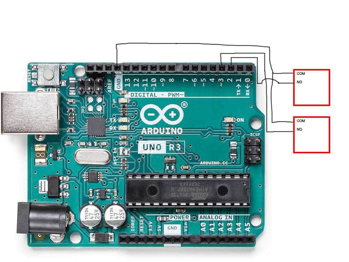

Hello guys,
I'm using Arduino UNO with an ethernet shield to read relay values. I'm using the internal pull up resistors and passing ground from the board to the relay contacts to read the returns.
This seems to be very unstable and reliable and has a latency of about 2 seconds. I thought initially that the delay was added when reading the TCP packets but I was able to verify through serial monitor that this is not the case.
My code is very simple and my ethernet shield is Arduino certified (no knock off hardware used):

Any thoughts on what could be the cause of this? Could it be that the internal pull up resistors are not reliable?

Schematic please!
Internal pull-up resistors are reliable.
How long are the wires between the relay and the Arduino?
I don't see your code checking client.available() before using client.read(). Perhaps the latency is caused by a timeout waiting to read a character from the client?
Try adding client.setTimeout(1) in setup() and later try client.setTimeout(5000). Does this affect the latency problem?
Sure, here is a doodle of my connections. I'm passing Arduino ground to the relay COMs and reading NO on digital pins 2 & 3 (4 & 5 are not physically connected). The relays are on an RF receiver which is bascially a black box to me with relay outputs.
The cable is about 5 feet long but I've verified the same results with short cables.

This won't fix your problem, as you already figured out by testing with short wires. But...
It's probably not wise to rely on the internal pull-up resistors alone with such long wires, they will tend to act as antennas and pick up electrical interference which could result in "false positive" detections. Add stronger external pull-ups (1K~10K).
Add a 0.1uF ceramic cap wired from the input to ground to help to decouple the noise from the input.
