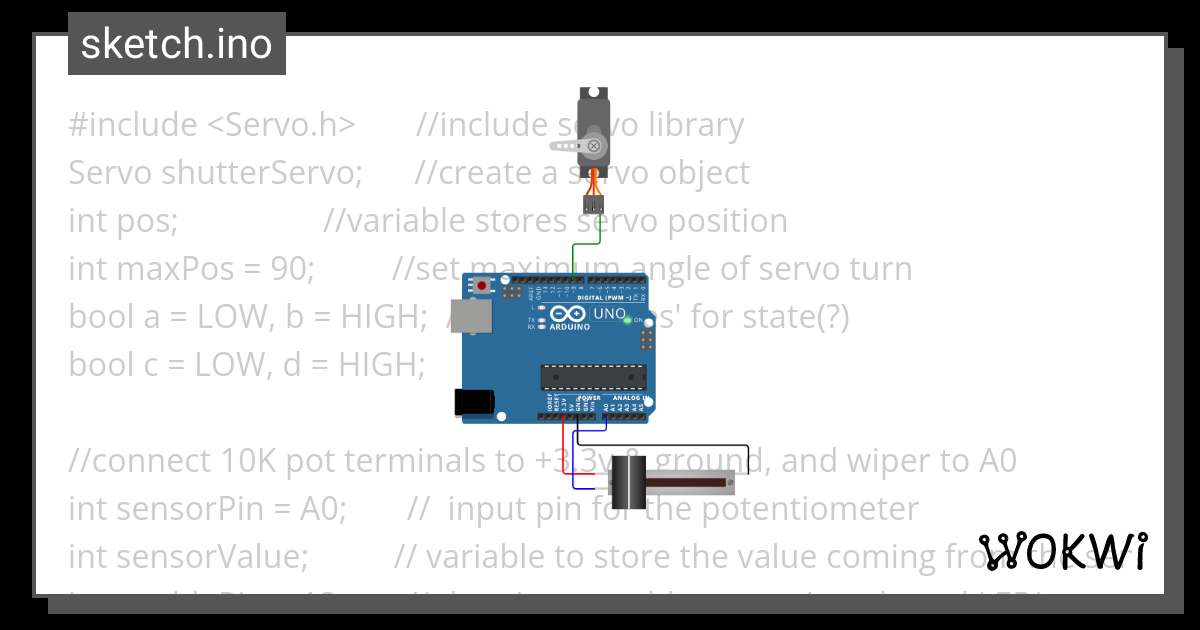

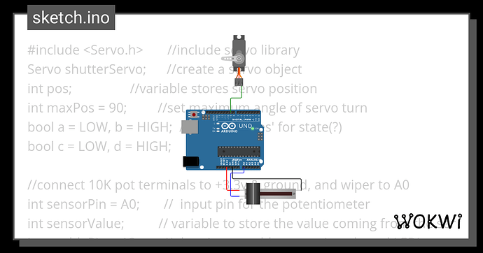

I create a simple wokwi simulation with just the servo and a pot
and it does work there fine
I'd be temped to say there is something fishy in the circuit may be
