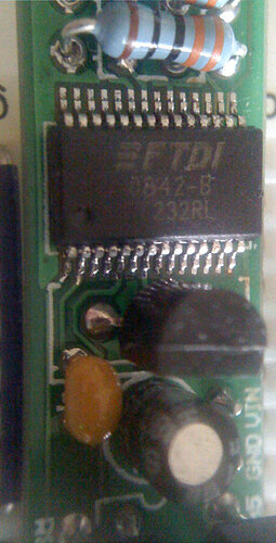

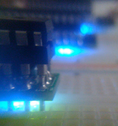

I got the extreme-closeup problem solved. Now you can see how bad my soldering is... and that I accidentally soldered the sockets in backwards. Here are a few more photos (I was having fun playing with my new toy):
Nice pictures. I mean, not breathtakingly beautiful, but plenty good enough to show how things are set up, in ways that weren't obvious on the lesser closeups... Useful! Good work.

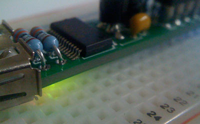

I got some new boards in, but I can't assemble them yet because I ran out of sockets. I've got some on the way, but until then I thought I'd show off the bare boards.
At the top is a board with built-in usb. I made a mistake on this one that I didn't notice until after I sent my order, so I had to cut a trace in a couple of places. This board also had some slight manufacturing defects in the solder mask, but nothing that should affect functionality.
The next one is like the last version, but with icsp added and a bunch of cleaning-up done to the trace routing and silkscreens.
The last one is a mini version. Like the very first one I made, it is designed to be powered either by the ftdi cable or an external regulated supply. This one is even even smaller though, at about .66 square inches.
