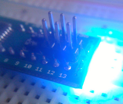

Here are my newest boards. I finally got my "thumbduino" idea to work, and it's a pretty nice little board, if I do says so myself. The analog pin numbering is backwards and I've already fixed that and added markings to indicate PWM pins for the next round of boards. The redesigned wirewrap boards are .02 square inches smaller than the duinothumb.com "world's smallest" board.

I need to do a little reworking because the pin labels are too small on the rebuilt version, which means another round of batchpcb prototypes, which takes the better part of a month. If I'm satisfied with the next version, having a panel made should be significantly faster. Does anyone have suggestions other than seeedstudio for where I can get these made one panel at a time for a decent price?
I'll have to do some math once everything including the pcb supplier is finalized, but I think I could sell the wirewrap board kits for under $20. The thumbduino board would be a little more.

I've been using the 168 for prototyping, but I'll probably sell them with the 328. They are all designed for 5V operation. The smallest one does not have a power regulator, but the extended version adds that (7805 or 78L05), a reset button, and an ICSP header.
A 1" tube would be a tight fit. The total assembled height is about 7/8", but for a permanent installation, you could probably bend or trim the pins to get it down to not much more than half an inch.
Of course, the Thumbduino without headers installed would fit a tube half that size.
