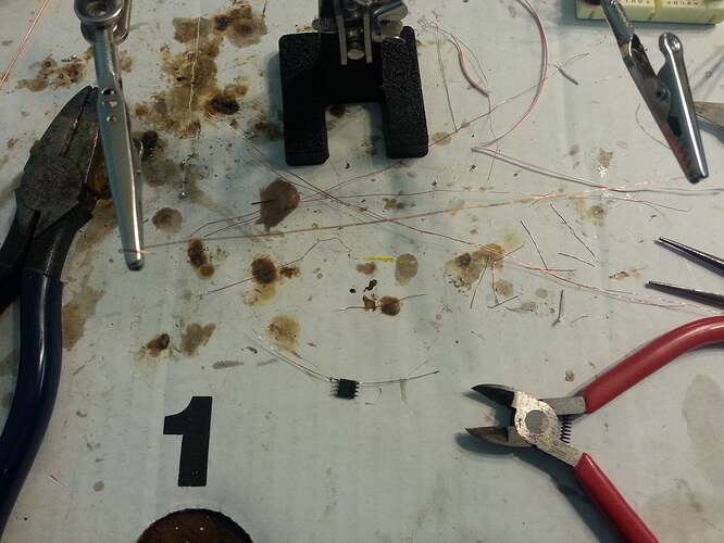

You won't find a socket for a SOIC chip because they are intended for surface mounting. You might be able to buy a PCB that you can mount it to but that will make the whole thing bigger - too big for your needs.
Using a socket with a DIP chip will double the height of the chip. I suggest you don't bother with a socket. But a few spare chips and practice your soldering. Get a fine tip for your soldering iron. These pictures show how I attached an Atmega 328 to an nRF24L01+ wireless module for a model train controller. It's not stylish, but it works.
For a more recent version I have used an Attiny 1634.
If you download the Atmel datasheet for any of the chips it will give you very detailed dimensions.
I don't think you need the capability of the Attiny 1634. The Attiny 45 and 85 are available in SOIC form as well as DIP form. Just make sure they have enough I/O pins for what you want.
I don't see any advantage of using a bootloader on an Attiny - it just consumes memory that you could better use for your project.
I don't know where you live but component suppliers like RS Components and Farnell and Rapid Online will have a huge range of LEDs
