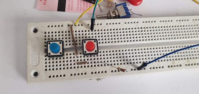

Hello, I am in the middle of trying to make a smart coffee maker for a school project. The only aspect of this that has been difficult is getting this display to work. It is a transparent OLED manufactured by Sparkfun. I will attach pictures showing why that is necessary for the project, plus it looks so cool!!! Only issue, it is such a pain to program. Right now, I am trying to get a button to update the screen with new text. Seems pretty easy, right?
Well, whenever I use pinMode(buttonUp, INPUT), which is in setup, the loop function does not run at all, nothing displays on the screen after the circleTest(). If I comment out the pinMode, the display goes on to show the text I programmed. Here is my code:

I know this is very poorly written, I just need it to work right now, I can clean it up later. If anyone has any suggestions for how to get this button to work, it would be greatly appreciated!!!
Also for anyone asking why I have 2 identical "Start" functions, if I run the original one more than 1 time, it won't execute. Still trying to figure that out too.
My main goal is to have two buttons to change the temperature readout on the display, and ultimately regulate the coffee maker to that temperature. Thank you for your help!!!
I suggest that you add some Serial.print/ln statements add strategic places to see what is going on.
Are you using pull-up or pull-down resistors for the button?
Oh, and which Arduino are you using?
How do you have your buttons wired?
If you have switch between digital input and 5V, do you have a 10K pull-down between digital input and gnd?
Without knowing which Arduino you're using this is, at best, a shot in the dark: you may have a memory size issue.

Hello all, thank you for your replies. Please assume that the hardware side of things is correct, as the display does function normally, and the button can work in a standalone program, but I have attached pictures kinda anyway. The display is soldered via a ribbon cable directly to an arduino nano, and the program uses about 80% ram. I know this is just a programming issue, but cannot figure out why I cannot get the button to change what's on the screen.
Thanks again for the help!!

OPs images;
Tom... :slight_smile:
I think you need to tidy up your soldering and check your connections.
