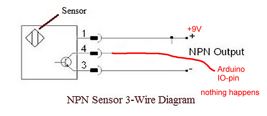

Help me!!!! Why the my 2 servo motor are not functioning properly, I only heard click sound but it didn't rotate. What is the possible problem. But the inductive proximity sensor are functioning. What do you is the problem coding or circuit?

What kind of proximity sensor is this?
Post the datasheet of your proximity sensor
Are you trying to power two servos from a 9 volt smoke alarm battery?
Can you try using a 5 volt power supply? A cellphone power bank is a better source, you'd have to cut into a USB cable and use the red (+) and black (ground) wires.
Or you could use 4 AA batteries for 6 volts (servos be fine).
With either 5 or 6 volts you would not need the regulators.
a7
Voltage regulator l7805cv
Inductive proximity sensor NPN. Here is the datasheet
Yes, 9v in 2 servo motor since the available battery I have right now is only 9volt , btw the servo is sg90 so I only need 5v to 6v , therefore I use voltage regulator l7805 each servo. But if I will going to use 4AA batteries, are you sure that the 2 servo will work? Maybe only 1 servo will work. If that will be happen , I will going to use another 4 AA batteries for the second servo?
No. But it is the next thing to try.

The datasheet of the proximity sensors has a schematic how to interface this sensor with a 5V input. The schematic has the information that the resistorvalues are for a supply-voltage fo 12V
As a general advise:
If you leave standard consumer USB-products like microcontrollers and electronic components you have to take care of much more details than just
"does the plug fit into the socket?"
As you have drawn it you connected the output of the proximity-sensor directly to the arduino-IO-pin.
Depending on the exact internal circuitry of the proximity-sensor you might have damaged your arduino. Might it is not a must. The schematic shows how to interface to micrcontrollers
The resitsors have values 150k and 100k. These values are used for a 12V supply.
If you supply with 9V the value on one resistor must be changed to again get a 5V signal from this small cicuit called voltage-divider.
And this is one of the details you have to care about as this is not a standard consumber USB-device.

As you have posted it without any load-resistor I guess nothing is damaged yet
If you use a single load-resistor the 9V which is way too much ! would damage the Arduino
You will have to use a voltage-divider to get 5V
Now the question is what value shall the resistor R1 have?
You can use this online-calculator to calculate the value
best regards Stefan
looks like the proximity sensor output is open-collector.
