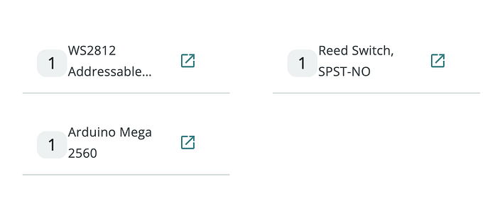

That project looked kind of cool, but there's zero substance.
The schematic is nearly unreadable.
The parts list dramatically underestimates the switches, leds and resistors:
The code works with only 24/64 of the LEDs? It can't deal with multiple pieces in multiple rows/columns?

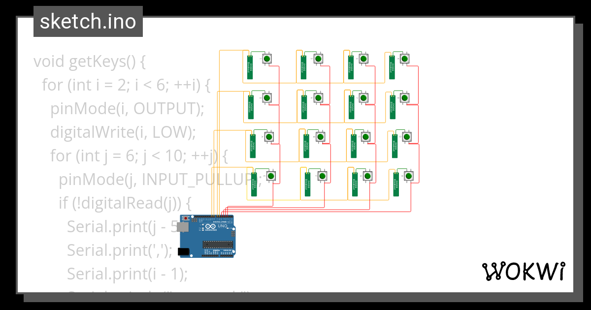

You can get started with no money and no equipment by using the wokwi simukator
The main concern is having sufficient resources on the board you pick. I don't think memory or processing speed will be of any concern, but you may need to think ahead about just how many inputs and outputs you need, and how you want to provide them.
LEDs for examlpe cloud take one output pin each, or a Neopixel strip could be 60 or more LEDs on just one output pin.
Similarly inputs like pushbuttons coukd take one input pin each, or a matrix of them could be arranged so that 36 inputs could use just 12.
Or add shift registers or multiplexing and do even better.
Build a reduced prototype with enough inputs and outputs done naively and see where you get. Then you'll be in better position to decide how to scale it.

Here's an implementation of a multi-touch diode matrix keyboard in Wokwi:
per Diode component (for making a matrix of switches) · Issue #349 · wokwi/wokwi-features · GitHub
Another version with change detection:
