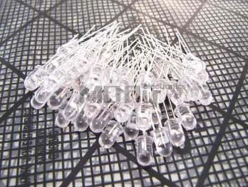

Yeah, if I can't figure anything else out I'm going to try opencv on a raspberry pi. But there's got to be another way. Wait, I think I got it! Would it work if I put a bunch of ir leds in the ball and used an ir sensor on the arduino? Any cons? Thanks
Would these sensors : http://www.ebay.com/itm/10x-IR-Receiver-Infrared-Module-38KHz-VS1838B-VS1838-Arduino-Remote-10pcs-T18-/151978175017?hash=item23629aea29:g:cysAAOSwFNZWuXU6
be able to pick up on these ir leds?
