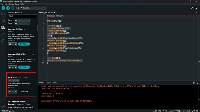

SoftwareSerial Library Issue
#include "GPS.h"
GPS gps(4, 5);
  Serial.println();
  while (!gps.begin())
  Serial.println("...DateTime...");
  Serial.println();
  Serial.println(gps.getDateTime());
  Serial.println();
  Serial.println("...Reading...");
  Serial.println();
  Serial.println(gps.readString());
C:\Users\Dev\Desktop\first_program\sketch_jan26a\sketch_jan26a.ino:1:10: fatal error: GPS.h: No such file or directory
#include <SoftwareSerial.h>
compilation terminated.
exit status 1
Compilation error: GPS.h: No such file or directory
I am getting this error How to resolve this?
Do you have this file on your PC and, if so, where is it located and where did you get it from ?
@UKHeliBob
Dawnloaded this from Library manager
What is the path to your Sketchbook folder in IDE Preferences ?
Your error message is confusing. It says it can not find GPS.h, but the line highlighted is for the SoftwareSerial library which you don't have in the sketch you posted.
It looks like you haven't installed that SoftwareSerial library, required by that GPS library...
The SoftwareSerial library is installed automatically with the IDE and @webydev looks like he/she is compiling for a Uno so the library should be available
I am suspicious, however, that the sketch is not in the sketchbook folder
@UKHeliBob Its fixed now i just restart the IDE Again and worked successfully

The error message is showing the #include line in the file GPS.h as the location of the problem, not an error with finding GPS.h itself.

This is the confusing part:

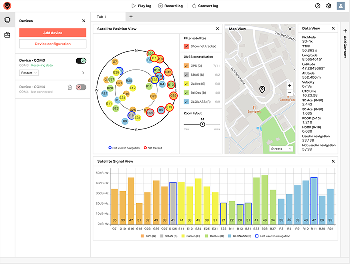

Have you tried running u-center
no i haven't used this before can you help me with this what it does ?
