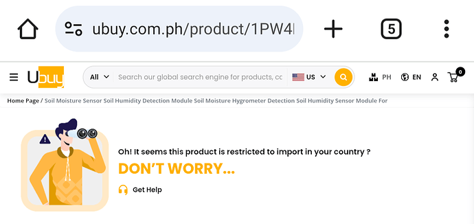

There are many types of soil moisture sensor which work with different principles. You must post a link to the description and specs of the type you are using.

Sorry about the inconvenience I made and I appreciate the clarification. Here are the specs the I used for reference as well.

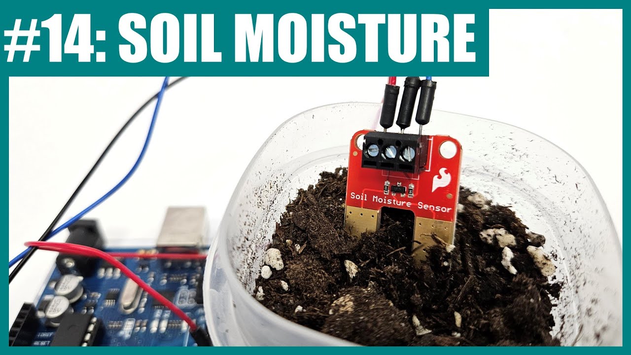

This is the video I followed along. I noticed that the soil moisture in this video has the opposite results of mine. I'm starting to think if I bought defective ones or maybe I'm missing something.

Does it look like this?
The sensor in the video is a different design to your sensor, I suspect. It may be wired differently internally and so give an output signal with different characteristics. That doesn't necessarily mean it's defective. From your description of how it behaves, it sounds like it's working fine. But that code was written for a different design of sensor, and so may need to be modified in order to work correctly with your sensor.

The sensor @cookie_doe is using does seem to be lower quality than the one in the video. The sensor in the video seems to have much larger conducting surfaces and they appear to be gold plated.
Personally, I made my own sensor from two lengths of galvanised steel wire held apart with a large screw terminal block, which has lasted for many years.
