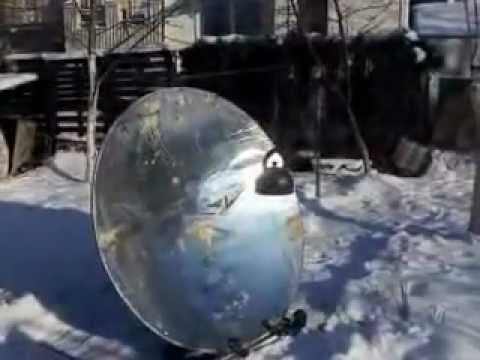

Solar heating with motorized satellite dish
Lets just say for a sake of the argument that code, which says that sensors are activated every 10 minutes is implemented
The sun moves at 0.25 degree per minute. It subtends an angle of 0.5 degree, therefore the sun will drift right across the focal point in two minutes.
That lives us with one electric motor activated just for short period, every 3 to 4 minutes, would you agree Mike?
This is theory of course...
This is Do it your self project mind you.
Size of the motors are again depending how big dish one wants to use.
Choosing right kind of motors depending in which country you are will live you with some mathematical equation
how big solar panel one should need to run it properly.
At this moment, I think that we should focus on designing code for LDR sensors, and later on output part of the code.
Do you generally find this agreeable?

To clarify:
Solar energy is transferred via parabolic mirror to focal point where is achieved high temperature.
Creating heat energy is dependent on 4 things:
Position of the mirror.
Amount of sunlight.
Size of the dish.
Time length of exposure to sun light
I agree that amount of heat energy is questionable here.
But there are ways of improving it.
Connecting 2 , 3 or more mirrors in series with pipe and using water as medium one can achieve 90 degrees Celsius of the medium.
There are primitive but officiant ways of accumulation of this heat energy during day light and exploiting it over night (for example).
You remember TA electric heaters?
They use to be popular 30 years ago...
Basically pile of bricks in a box use to accumulate heat energy over night when electricity was cheaper ( in some countries)

I understand the principle. I just wanted to raise the concern that the amount of solar energy captured might not exceed the value of the electrical energy needed to drive the system.

I feel I have been misunderstood again.
I am not saying I think there is a problem. All I am saying is that if it was my project I would do some measurements of energy capture before committing to the project to ensure that I wouldn't be disappointed.

Winter is coming here in 2 months.
Than I will be able to do measurements my self with 1m dish I am preparing.

Guys,
Tell me that I am wrong,
But my impression is that you constantly have in mind solar system based vacuum tubes.
I must remind you that they are commercially sold systems.
That means lots of marketing and lots and lots of manipulated data.
Solar system based on CSP( concentrated solar power) is slowly coming on the market.
Biggest problem with CSP is complicated electronics, structure which holds everything together and mounting.
This is one example how to build it relatively cheap:
Using it just in summer for water heating can save huge amount of electricity.
I am more than willing and ready to put all my money in building CSP system.
Well, at least smaller version of it for beginning.
