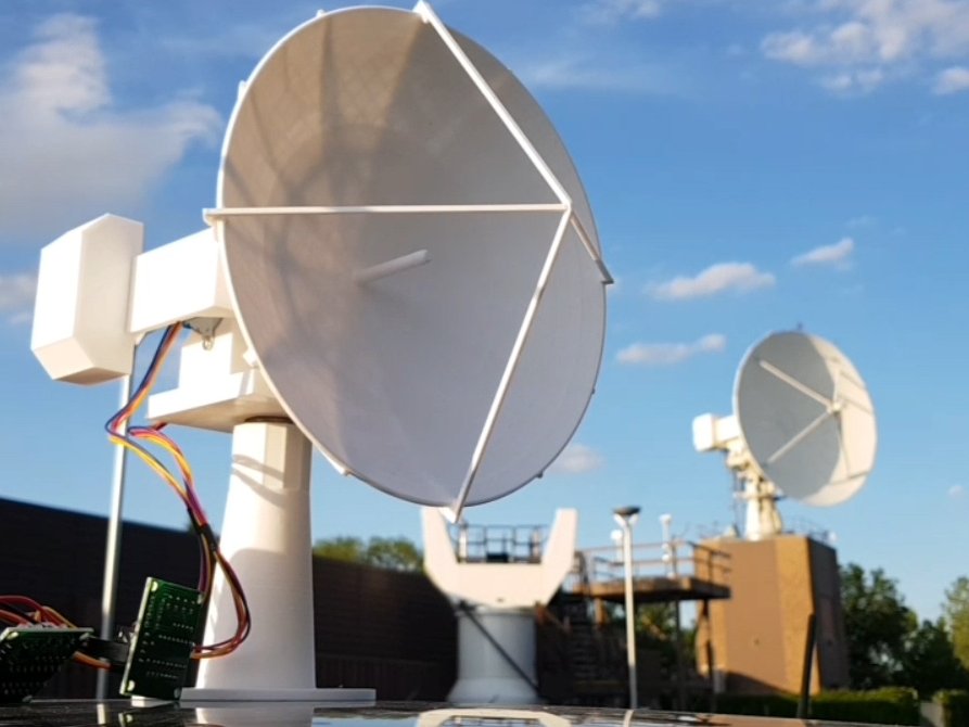

Satpack: Arduino satellite tracking and doppler tuning - Make: (makezine.com)
this seems to be popular!
You look like being well equipped with knowledge about the stuff needed.
Fascinating project. Good luck!
